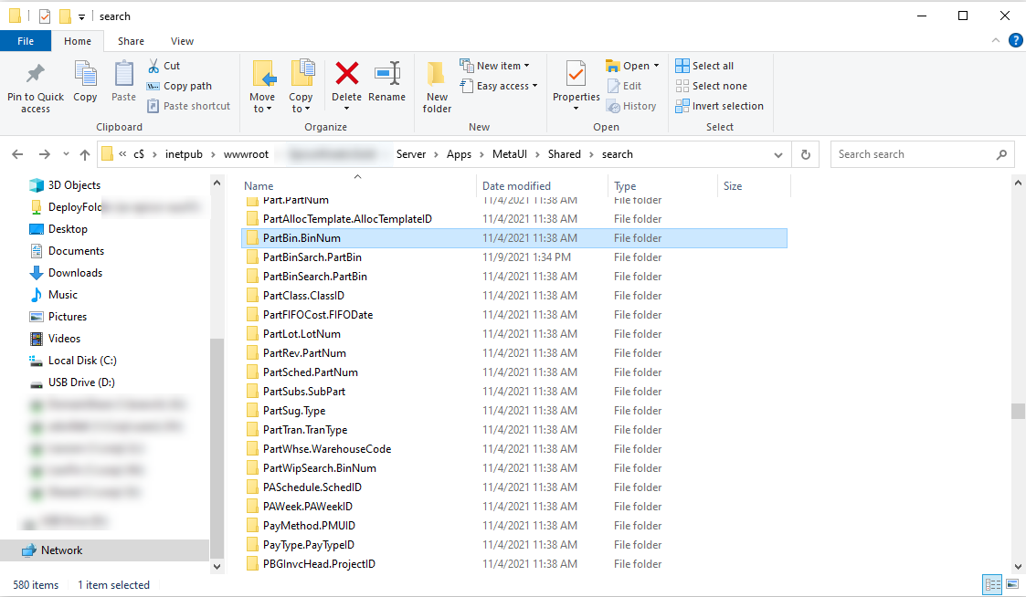

The only way I have found to make custom searches to to modify the JSON on the server, then run Conversion 191 to move it into the XXXDef table.
Outside of that, you may want to go with a BAQ or Quick Search.

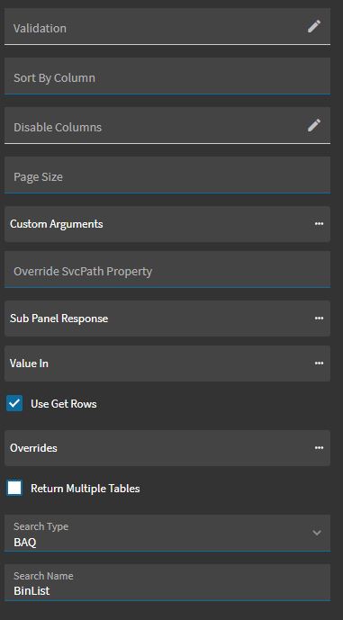

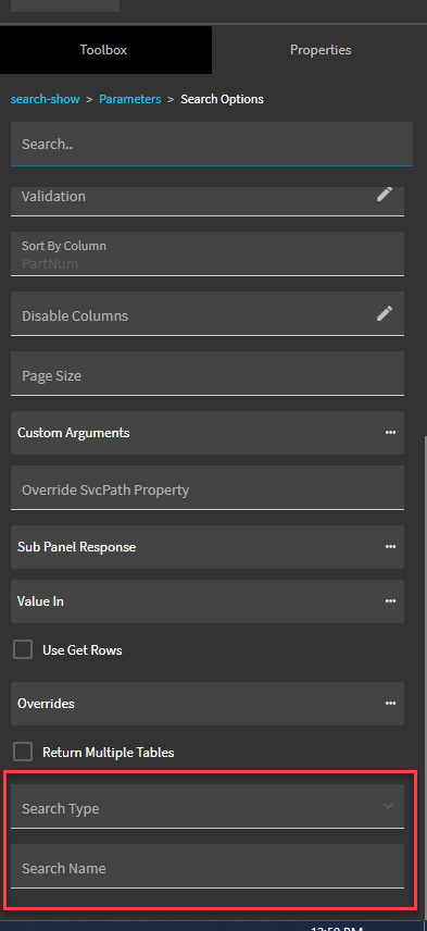

So, I copied all the event widgets for the locked event: InvTrans.ToBinNum. I pasted them into a new event with identical triggering. The only difference is that I navigated to search type/name and put in my new BAQ. I created a BAQ like this:
select
	[WhseBin].[WarehouseCode] as [WhseBin_WarehouseCode],
	[WhseBin].[BinNum] as [WhseBin_BinNum],
	[WhseBin].[Fullness_c] as [WhseBin_Fullness_c],
	[WhseBin].[Company] as [WhseBin_Company]
from Erp.WhseBin as WhseBin
I also set the BAQ Search Like columns to include Company, Warehouse, and BinNum. I shared the BAQ and saved it.
Now When I click on the bin search icon, It brings up the sidebar in BAQ mode, with nothing else in it. No options or results or errors. I must have done something wrong here.
Can you take a screenshot of the search options?
Do you mean the BO, method and parameters?
1

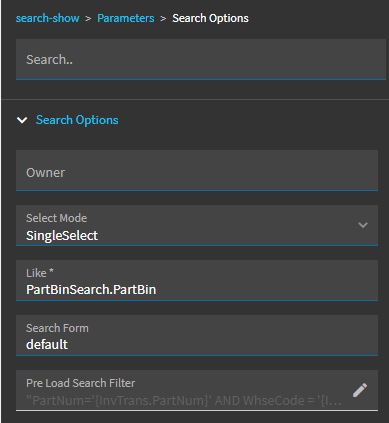

It’s likely because you’re using the “Like PartBinSearch.PartBin” and your BAQ is using WhseBin.
Actually, you know what? This one is finicky. Let me try something. Hang tight.
Change the “like” to PartBin.BinNum instead of PartBinSearch.PartBin.
That did do the trick! It is not exactly what I want. But for today, I am chalking this up as a win! Thank you my friend!

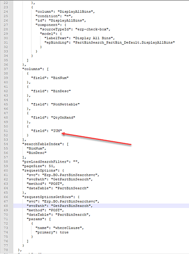

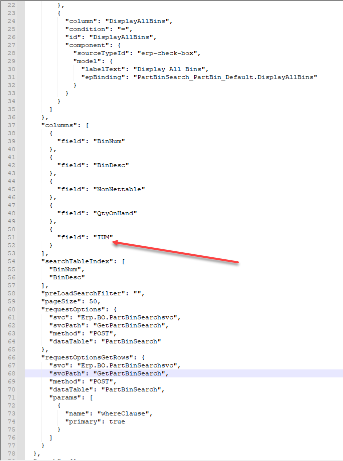

Just for reference, adding a field to the original search (assuming server access) is as easy as adding the new field here:
Save, then run conversion 191. Boom. New field in search.
**Note: upgrades may or may not break this. Haven’t had a chance to try. Patches don’t (so far).

How can I filter my BAQ results to include only those rows where the part number and warehouse match the selection on the Inventory Transfer form?
Was that “Preload Search Filter” not working for you?
