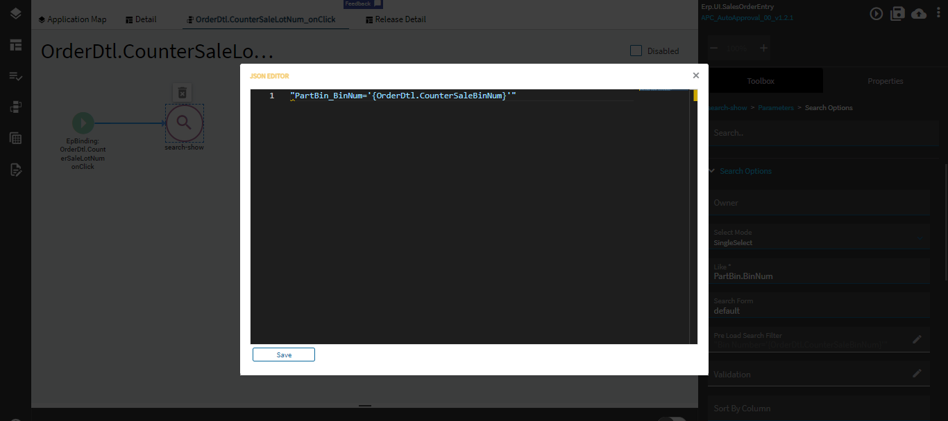

Hi @hmwillett , how can I create Quick Search use BAQ
and How can I put preload search filter in Appstudio use tool Search Show

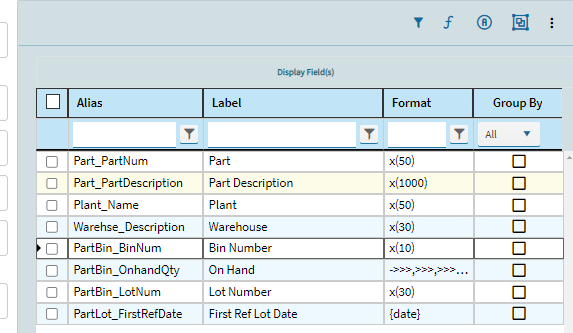

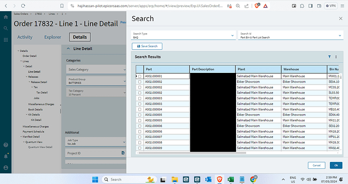

Hi @hmwillett, I tried this but nothing happen. Is there any next step? I have already added the field and run the conversion 191. My current version 2021.20
Hi @hmwillett @NateS ,
I try your suggestion but still is not working
