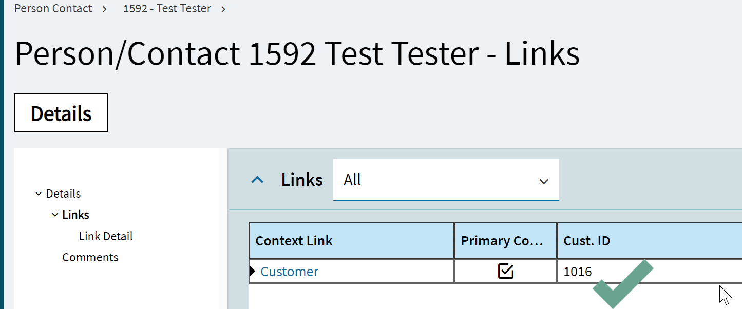

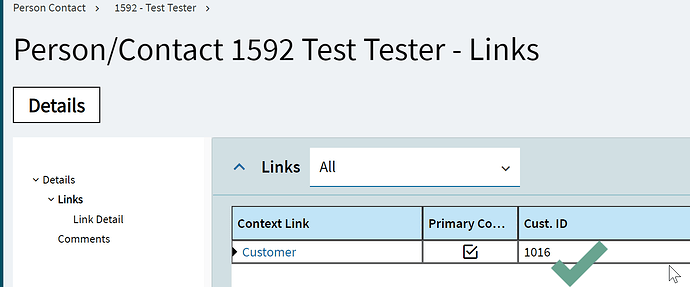

Subsequently ran it with (what I think is) correct data:
Company
ConNum
CustNumCustID
PerConID
KNZ
0
1016
1592
I’ve checked via sql table erp.custcnt and there don’t appear to be any records with the wrong ConNum, in particular none with ConNum =1592.
Looking at custID 1016 that looks correct:

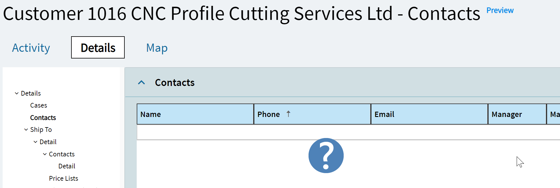

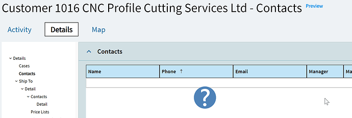

As far as I can tell all is as it should be here. But contacts just do not appear:

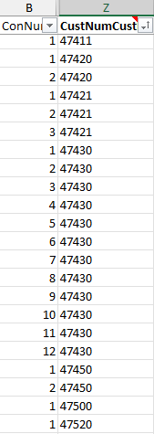

When I did our initial Customer Contacts DMT once upon a time… I had to write an excel expression to give me a running count per CustNumCustID for each contact.
See below image (I hid all the detail columns) but this should show that each time the CustNumCustID changes… the ConNum restarts at (1).
As for why they’re not showing on the Customer > Contacts screen… I’m not sure about that.

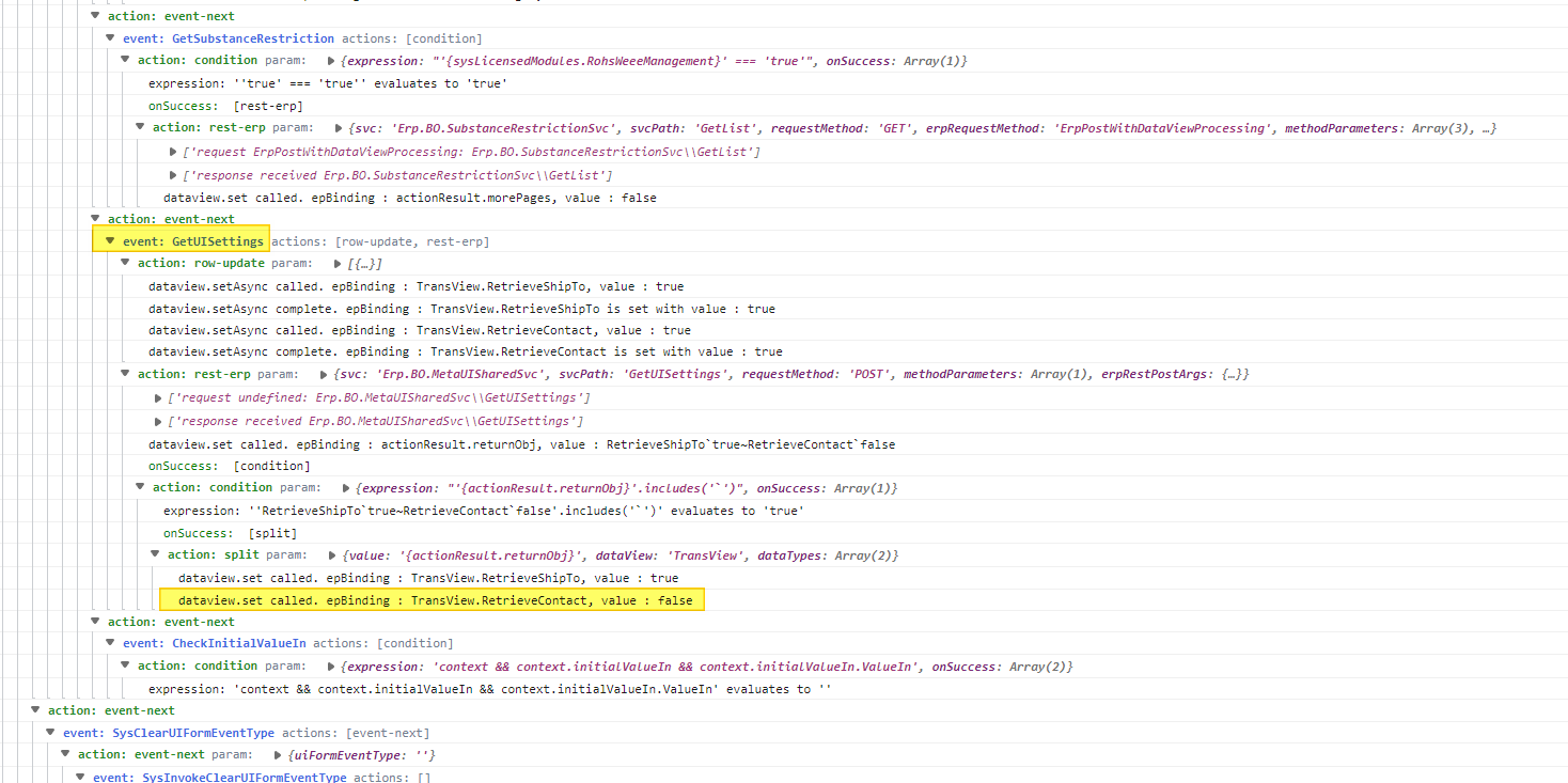

You are correct this is a custom layer, however its broken the base unmodified Customer menu entry also. I am wondering however if its app studio related, but have gone back to a “new layer” and preview of that still shows no customers, and Contact data view is empty
Also. You see in my data ConNum was 0 in DMT, but gets set to 2 automatically. ConNum uniquely increments per Company/CustNum/ShiptoNum combination, so don’t believe that’s the issue.

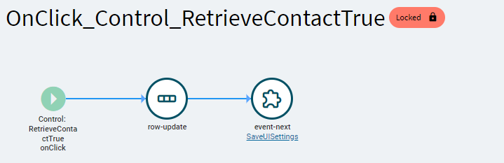

I used dev tools in another older database, where contacts were loading.
There’s a RetrieveContacts event that fires, that does the retrieval, but only if TransView.RetrieveContact is true. On the old db where it was working it was true, on the current db it was false.
I also found system events to set this to true or false, though don’t know where the controls “RetrieveContactFalse”, “RetrieveContactTrue” is, I sure can’t see them…
Anyhoo, duplicated this event on my own button, clicked it, and contacts are working again.
Still begs the question: what changed this setting before? Nothing I have done I am sure, I had been DMT’ing in contact data, not playing at all with app studio when it appeared to break.
