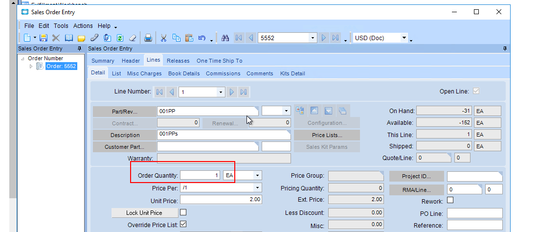

1st screen, Order 5552, Line 1, Qur Shipment Qty = 1
2nd screen, Shipment you are shipping 1000 Qty.
How to stop shipment, if Shipping Qty > Order Qty (1000 > 1)
That is my question.
I know system is allowing more quantity than order quantity.
