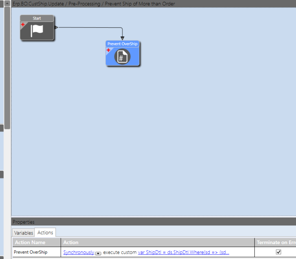

Thanks for the head start. This is what I came up with. I added this as custom code.
var ShipDtl = ttShipDtl.Where(sd => (sd.Added() || sd.Updated()) && (sd.OurJobShipQty + sd.OurInventoryShipQty > sd.OurRemainQty)).FirstOrDefault();
if(ShipDtl != null)
	var message = "You are attempting to overship this line. Please correct before you can continue.";
	throw new Ice.Common.BusinessObjectException(
	new Ice.Common.BusinessObjectMessage(message)
		Type = Ice.Common.BusinessObjectMessageType.Error,
Ken,

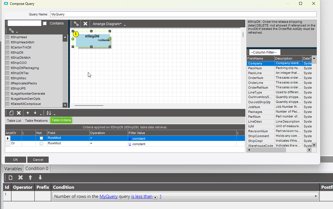

Hi Ken,
Can you please let me know where to write this code.
Here is my screenshot where I made the condition. Please can you guide me.
2024-07-31 10_08_18-BPM Workflow Designer
Still in production. Code is above.
