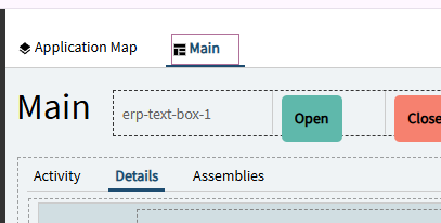

Does anyone know how to customise the Hero Bar, specifically on Job Entry/Tracker?
We’d love to add another shape, but Application Studio doesn’t seem to let me drag anything onto the bar. Has anyone managed to customise it?

You just have to make sure you are on the right layer. You might think you are on the layer containing the hero bar but you aren’t.
Also drag your control to the beginning of the bar and drop it, then use the arrows to move it over if you don’t want it to be first.
Aha, this is what I was missing, thank you so much :smiley:
