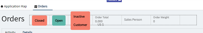

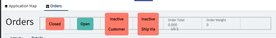

Next issue, in Order Entry, the Hero Bar no longer displays the Salesperson, which is a built-in field (I didn’t add it - its there in base). I can kind of see what happened - we had customized the hero bar to display some additional information and hidden some of the built in info (like currency). It appears Epicor has now added another tag to the hero bar for Inactive Ship Via. But in doing so it seems it can’t figure out how to add the new tag without wiping out the existing field.
Before (2021.2):
After (2022.2):
Even if I wanted to fix this by adding the salesperson back as a custom text box, I can’t, because application studio won’t let me add or rearrange text boxes in the hero bar in 2022.2. I discovered that if I drag the text box to the hero bar (and it looks like nothing happened), but then save and close and relaunch, the new text box control then magically appears. But it is impossible to move it to the right location on the hero bar. Then if I try to delete the text box, it again won’t delete unless I save close and relaunch again. I can’t believe application studio is even worse in 2022.2 than it was in 2021.2 but this is wholly unusable.

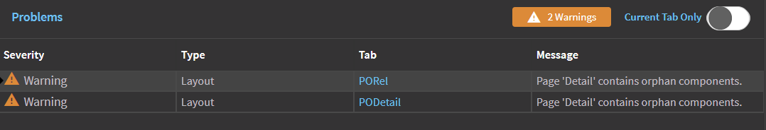

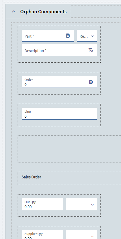

Over the weekend I updated from 2022.2 to 2023.1. Like what you had experienced with 2021 to 2022, few custom layers are “broken” and displays a warning message like this.
So now the these layers have the orphan cards with fields.
This appears to be a result of the conversion program not able to process the customized layers. Are we to manually fix this or is there a better way?

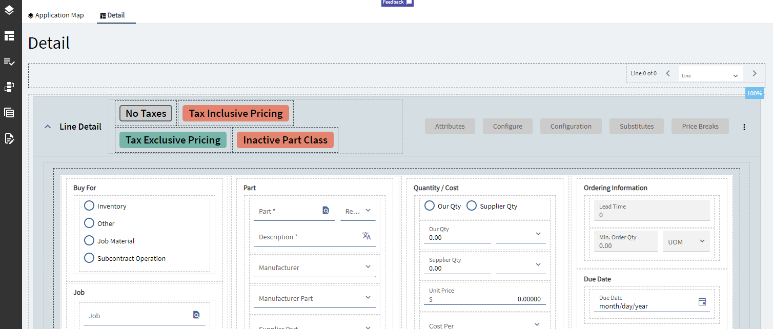

In 2023.1 Epicor has moved fields around, quite significantly in some apps. There are new elements as well. How do we reconcile all the changes?

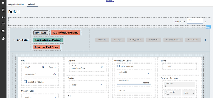

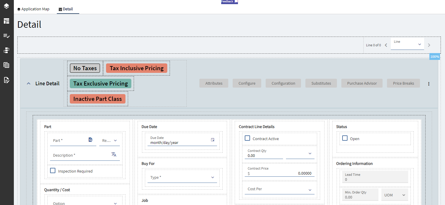

Here is an example of the base PO Entry Line Detail layer from 2022.2
and 2023.1
