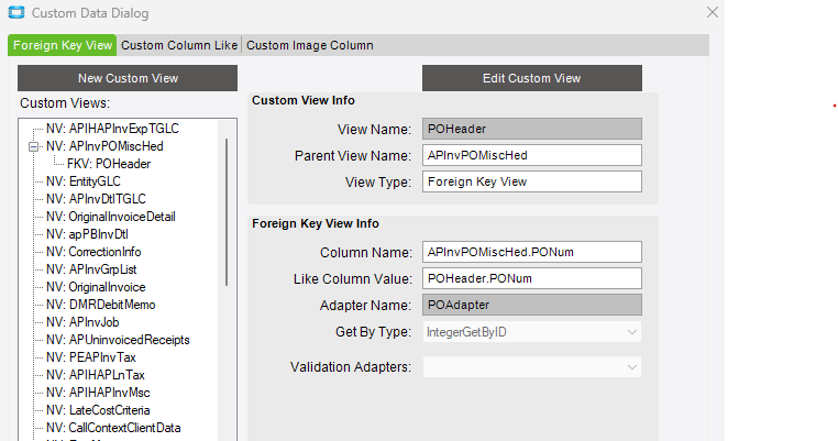

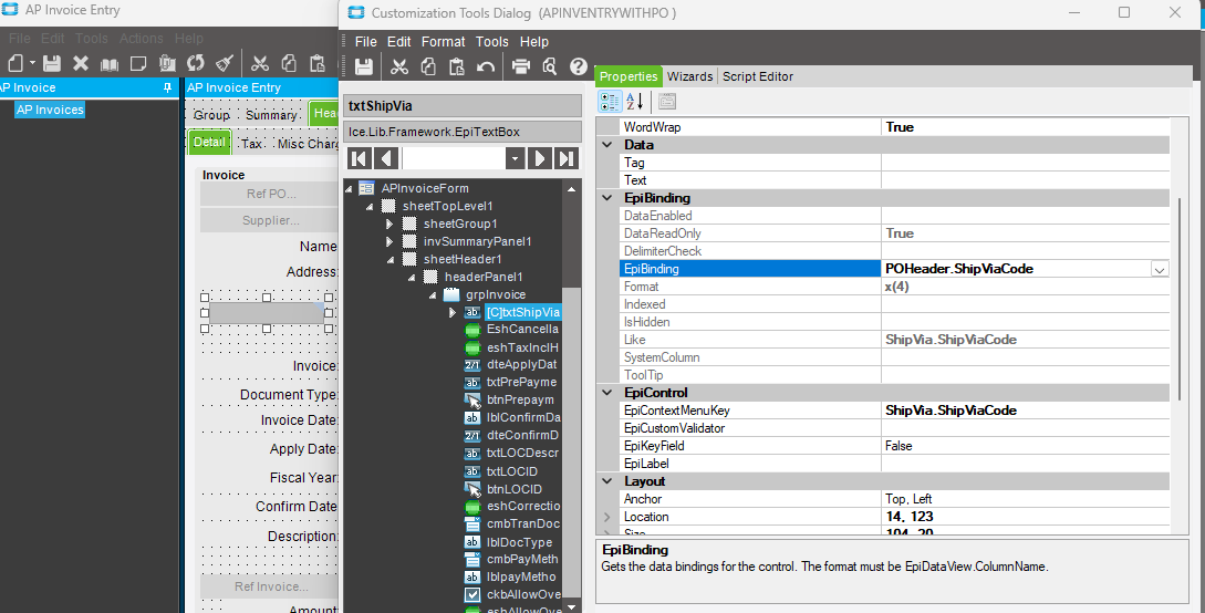

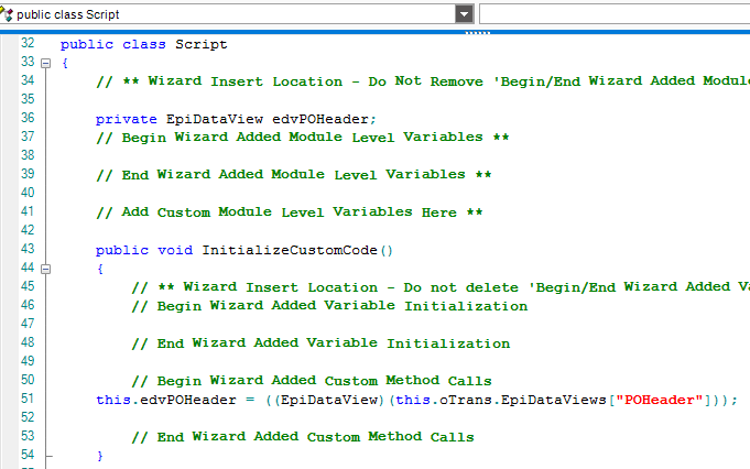

Hey Kevin. After Steve’s comment I dug into the customization guide and found a couple of threads that suggested maybe I could do this with a Foreign Key View. Here’s what I tried:
script
This does not produce any errors, but does not seem to work. I have not had a chance to test this with a real invoice, but it does not seem to display the ShipVia if I create a test invoice and bring in a PO.
