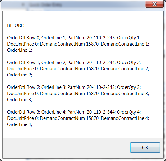

These are the OrderDtl record contents just before the Update method:
