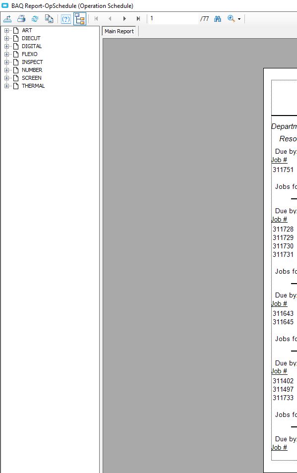

Gotcha. I have no idea if we have that or not as I have never seen it or been told about it. Overall I want to move to all SSRS. One of the big questions i get is can we do things similar to Crystal in SSRS. What they mean by that is in the pic below. IS this possible in SSRS?
You can do MOST of everything in SSRS that you can do in CR. That screenshot is of the CR Runtime viewer. SSRS reports can be previewed as a PDF.
