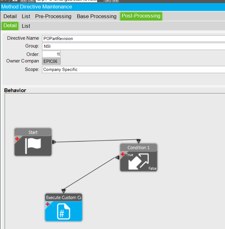

I really like the solution propose by Hogardy using BPM with Method Directive Maintenance. I’m running into a bit of an issue and doesn’t seem to be triggering it. What is the difference between the following:
Erp.PO.ChangeDetailRevisionNum
Erp.PO.ChangingDetailRevisionNum

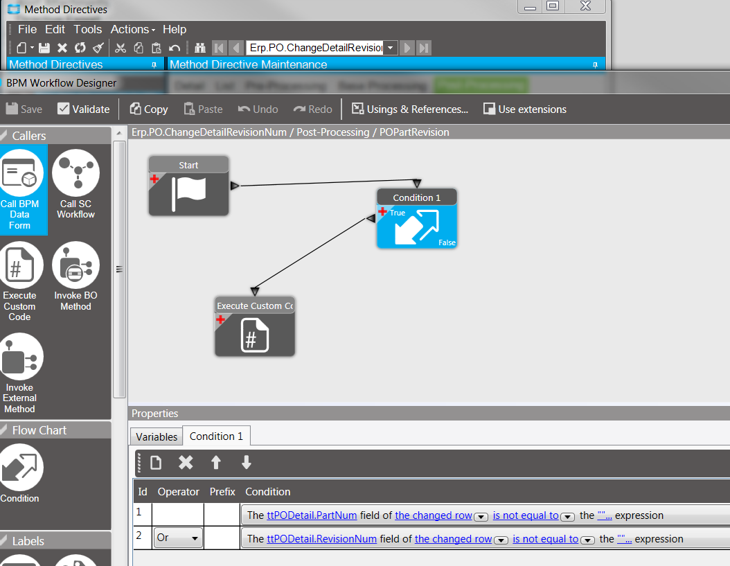

I want to pull what’s in the PartRev table whenever the PO RevisionNum changes. So this is what I did.
  1. I created a post-processing (I tried pre-processing and no luck either).
  1. I create a condition that if “RevisionNum” change and not empty, then execute custom code.
  1. Pull comment from PartRev and updating the PO -->Lines–>comments. In this case I just want a pop up message to test to ensure it triggered it. However, I am not getting anything.
I found the pop-up below and seems to be working somewhat. It only pop-up if I change the “RevisionNum”. If it auto-populate the RevisionNum when I change part number, it doesn’t fire off the pop-up.
this.PublishInfoMessage(“Testing 123”, Ice.Common.BusinessObjectMessageType.Information, Ice.Bpm.InfoMessageDisplayMode.Individual, “”, “”);
Just add the condition “OR” partnum change with your revisionnum change… it will fire on either change!
Pierre
I did tried that as well without luck. It works if my Method Directive code is set to Erp.PO.ChangeDetailPartNum. However, I want to trigger it when there’s a revision value.
This is what I have.
I see…well assuming it is valid to transfer comments on a part change OR or revision change…Maybe use the update method instead?
On new row call your custom code
On a changed row, if field partnum has changed or if revisionnum has changed
call your custom code.
That should work

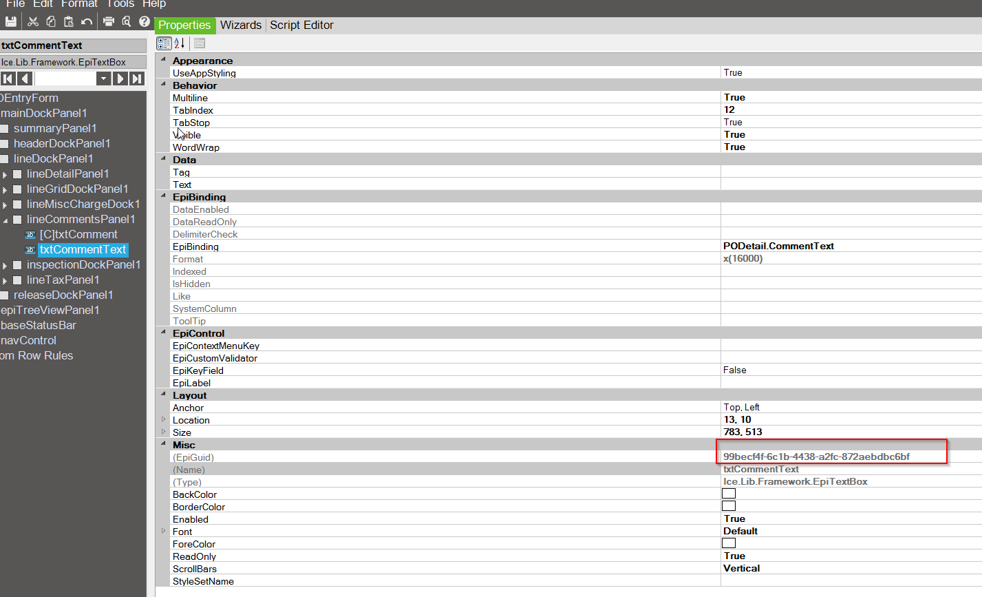

For whatever control you are trying to add it to, are you copying that controls GUID?
You can also look at the EpiBinding field of the control (example, Part.Description) and do:
var edv = oTrans.Factory(“Part”);
edv.dataView[edv.Row][“Description”] = “Your value to set”;
This is what I want to add my comment to is the PODetail.CommentText. So I went and copied the EpiGuid from here. However, kept getting error that “The name ‘txtCommentText’ does not exist in the current context”.
Thanks again Chris. That other alternative worked. I would like to understand why it didn’t work with using the control and GUID.
