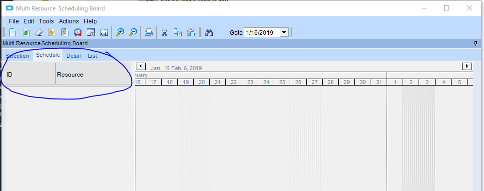

Has anyone figured out how to add columns to the left grid on a schedule board?
I have done so, but it is not for the faint of heart… It uses something called PlexityHide.GTP

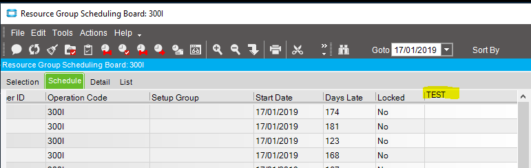

Put this together quick for proof of concept…
using PlexityHide.GTP;
Erp.UI.App.MultiResourceSchedulingBoard.ListPanel panel = (Erp.UI.App.MultiResourceSchedulingBoard.ListPanel)csm.GetNativeControlReference("2a0f08ca-a115-4547-999a-e658594fa6b5");
var grid = (PlexityHide.GTP.Grid)panel.Controls[0].Controls[1].Controls[0];
var col = grid.Columns.AddNew(CellType.SingleText);
col.Title = "TEST";
great job mate, i tried it on the Resource Group Scheduling Board UI and worked fine, i am very interested to see your code to fill this new column from any relevant linked Db.table
