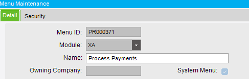

In dev mode, when launching the sub form from the main, does it give you a menu id when you launch the sub form? (Popup)
Yea, I tried to deploy that to the menu and that didnt work either. The customization does not show under process payments.
Which menu? Did it give you one like ‘PRblahblah’?
Look under Processes → Restart Process Payments
MenuID → PR000421
This is the one i am showing. Also i only see PR000419. It does not go higher than that.

There is some definite backend work going on. The same action calls either 371 or 421 based on the status of the payment group. You can make a customization on 421, but they are only listed as selectable for 371. I added -c custom name in the 421 menu table and it is ignored.
