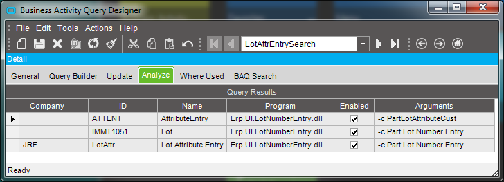

So this appears to be a bug, given that I’ve been using this for years. A hacky way to fix might be to set the Argument field of the Menu table (using an updatable BAQ) to the correct argument (which specifies which customization should be applied to the program). Below, I have a screenshot of a couple of menu items I have that use different versions of the customization.
Because the same program is used, the only difference is the actual form that is called and subsequently customized.
in this case, my customization “PartLotAttributeCust” is built off of the lot attribute entry form, whereas the “Part Lot Number Entry” customization is built off of the Lot Number Entry form. Both forms reside in the Erp.UI.LotNumberEntry assembly, but are called conditionally when appropriate. I used to be able to select the correct customization from the list, but in 10.2.200.3 it seems to not work anymore.
Try setting the argument and see if that works.

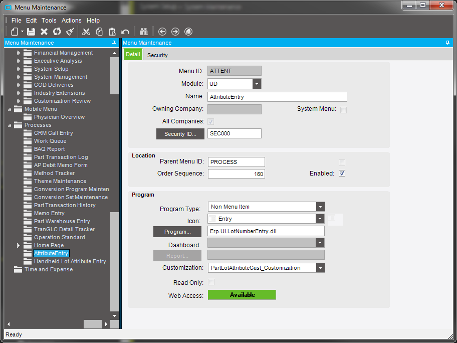

Aaron,
We are on 10.2.200.7 and still have that listing issue. I did the Updatable BAQ approach and it looks like it worked afterwards I looked in the Menu Maintenance and it looks like I can free from it as well. I will test it later as the updateable BAQ added the _Customization to the end so I may need to add that too. After adding it the Lot Entry screen broke so I had to add the calling process so that it would call the customization on that screen.
