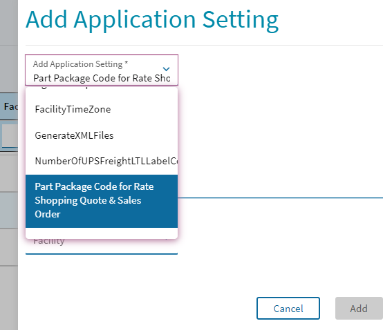

There’s also an application setting within Quick Ship that I think has to be set to true for the rate shopping to actual use the package code data:
This is greyed out for me. I enabled Package Control at the Site Configuration. Is there something else I need to do?
Nevermind. I did it again. I just read more in the help and there’s a check box on the Part Detail screen that says: Package Control Specific UOMs. That needed to be enabled. I don’t think I needed to enable Package Control at the Site Configuration level.
