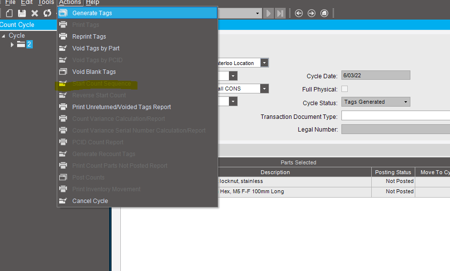

Have you already done actions + Print count tags/sheets and actually printed them or print previewed them?
Yes I have.
And you still can’t start the count?
Nope.
Do you have any cycles not posted for those parts or those warehouses that you have selected?
Any past cycles?
Are there any physical cycle counts open that need to be cancelled or completed?
Check any and all past physical cycle counts for that location and make sure that they are all completed and posted.
That’s what it was. An old full physical inventory test was hanging around and open. Cancelled it and it allowed me to start the cycle. Thanks for you help Utah!
