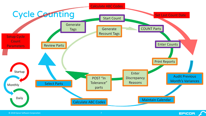

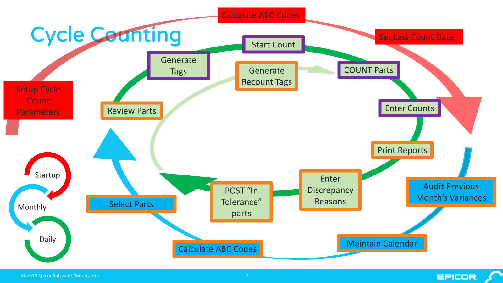

Here is my woolpool slide on the cycle counting process… note the colors… RED is the initial setup. BLUE you do once per period (monthly) and GREEN is done daily. Also note that you do NOT have to have cycle day 1 completly posted before starting on day 2… you might have some discrepencies remaining in recount, but that is ok. you can be doing your recount for day 1 at the same time as the count for day 2 is going on… same for day 3, and so-on.
