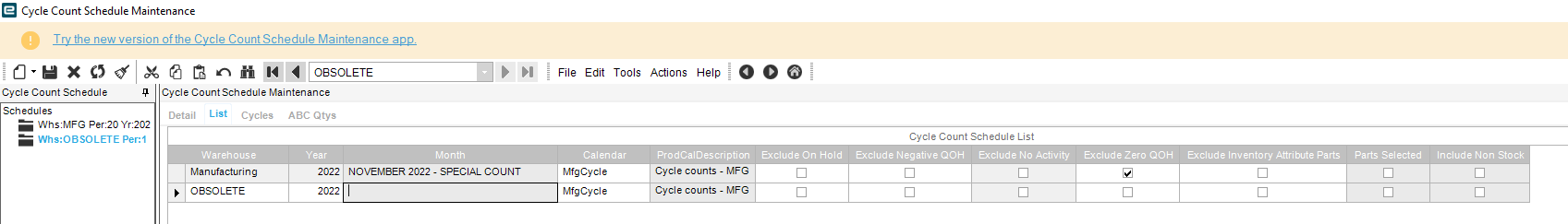

For the inventory that we do have on-hand, we want to cycle count. Unfortunately, Epicor’s Cycle Count process does not consider ‘Non-Stock’ parts in its generation of the list of parts to be counted.

Thanks, but I understand the difference, and everything is working as intended except that I can’t cycle count the stuff we have on the shelf. We want all of these parts to affect QOH and hit the inventory GL, show up on Stock Status reports, etc. The problem is that our cycle count parts list is always empty because all of our parts are considered Non-Stock. If there was an ‘Include Non-Stock’ option for Cycle Counts as there is for Stock Status report, that would be wonderful. But alas…

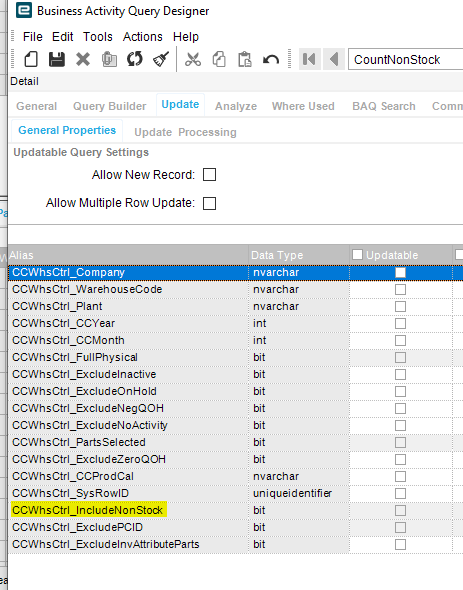

So, the field exists (hidden) but it’s read-only and defaults to false.
Curious if we can hijack it to work anyway…
[Edit]
Bah! Can’t even override in a uBAQ!
Booooooooo.
How about a BPM to set it when the CycleCount is created?
