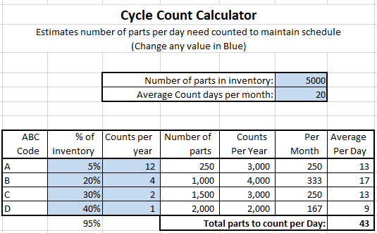

The word “Random” can have two meanings here… and in my way of looking at it, “Random” returns a consistant number of part numbers every day, verses Repetitive, which returns a random number of parts.
For this reason, i like to choose Random, and set the number of parts to count daily to be HIGHER than needed so that you still get your consistant counts, but the cycle counts are the same size every day. Repetitive can result in peaks and valleys for counting… See the screenshot of the spreadhseet below… image (and attached)… it helps you decide how many parts to count on a daily basis… just bump each count by a few percentage points, and you will “overcount” your inventory every year.
Cycle Counting part count Model.xlsx (11.0 KB)
