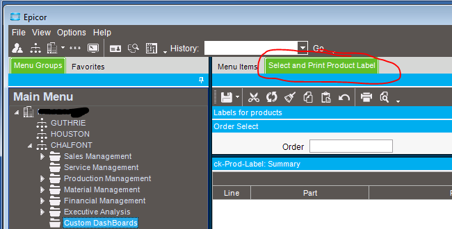

The only place I see the Deployed Dashboard is where it was added to the manin screen as it’s own tab:
Selecting Developer Mode doesn’t give me context for customizing the deployed dashboard.
How do I customize the Deployed Dashboard?
