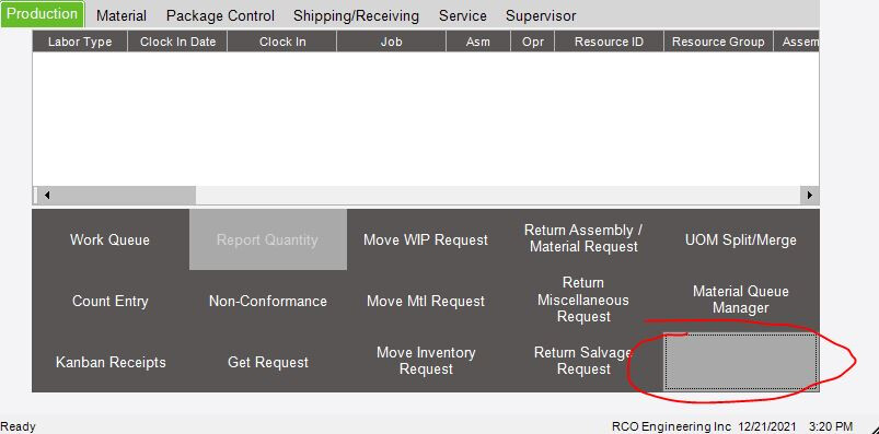

Hi knash,
I am actually that far already, but the button still doesn’t show up or launch the dashboard. Notice that the line of code in my Click event code is the same as yours. Is there something else wrong with my code?

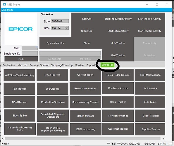

I ended up adding another tab. adding buttons and click code was much easier then.
This fixed it in combination with deleting the default MES.NotUsed EpiBinding on the button.

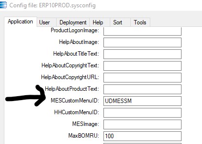

However, now I have a follow up question. The MES Menu customization that I have created to launch the dashboard, how do I set that as the default customization to be applied when loading MES?
Thanks for the help Ken!
You need to update the sysconfig file.
Screenshot 2021-09-29 074913

Yes, I do know that I have to modify the sysconfig file with the custom MES MenuID, but my question is where would I find the menu item to apply the customization to in Menu Maintenance? Would I just create a new menu item, select the MES Menu program, and call that MenuID in the sysconfig file?
If you have a Menu already you can use it. If not I would make it under Processes so its basically a hidden Menu. Yes, you need to make it via Menu Maintenance first.
