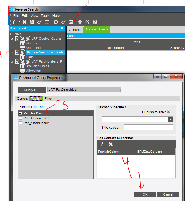

Here’s some screenshots that might help. I just drafted this up for a co-worker so this works out great!
Publish:
On your main query, select which column(s) you want to publish the values for. Think of this as a key field that will help the dashboard link it to a separate queries result. Make sure you select the actual query in the tree view and not the “grid” object. Click properties and select the publish tab. Select your columns to publish. The satellite icon will appear facing to the right when publishing, to the left when subscribing, or both if doing both.
Subscribe:
Set your child queries to subscribe to the published columns following the same steps as above. Select the filter tab on the Dashboard Query properties dialog and filter a column to the published value. It should appear in the list of options to filter by. Be aware, you can publish multiple values, so select the right one for the situation.

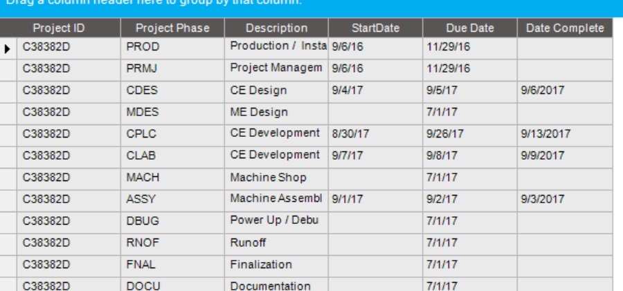

Now I think I just have one more challenge before and I can commence to creating my “master” dashboard for the project managers.
I need to turn row data into columns, having a single row for each project with all the data on it. To explain further, Instead of having individual rows for each project phase, I want one row for each project and individual columns for each Project Phase, Desc, Start Date, Due Date, Date Complete. (Basically transposing)
Any tips on how to do this? I have seen the PIVOT query but don’t know how to apply or even if it will work.
