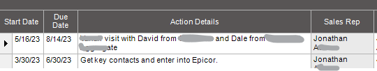

Has anyone successfully customized a dashboard to have multi-line column headers? I followed this thread and tried piecing some code together that a user stated worked for them.
The code compiles successfully, but the result is seemingly no change at all on the Dashboard. The columns behave exactly as before (dragging the width narrower does not “line-break” the text.) Is that not what I should’ve expected to happen? Should I be adding some kind of line break character in the column name text?

EDIT: Move your display code to the Form Load event. I don’t believe it will work in the Initialize Custom Code. As some extra, you can also set the default row height and make your data rows also wrap text. I included that below. It will look like this.

Thank you so much for the help. I think I’ve got it structured correctly now, with the display code moved to the Form Load event, along with your other lines (which I’ve commented out for testing the header).
This is still having no effect at all on the column headers:

Is there anything else I’m supposed to do outside of the customization to get the desired effect? I’ve tried Redeploying, clearing client cache, reloading Epicor.

You’re triggering that off of InitializeLayout.
That’s already run most likely at that point.
Just do it on the grid directly.

Yes, thank you! This was the last piece. For anyone else looking, here is what my final code looked like:
