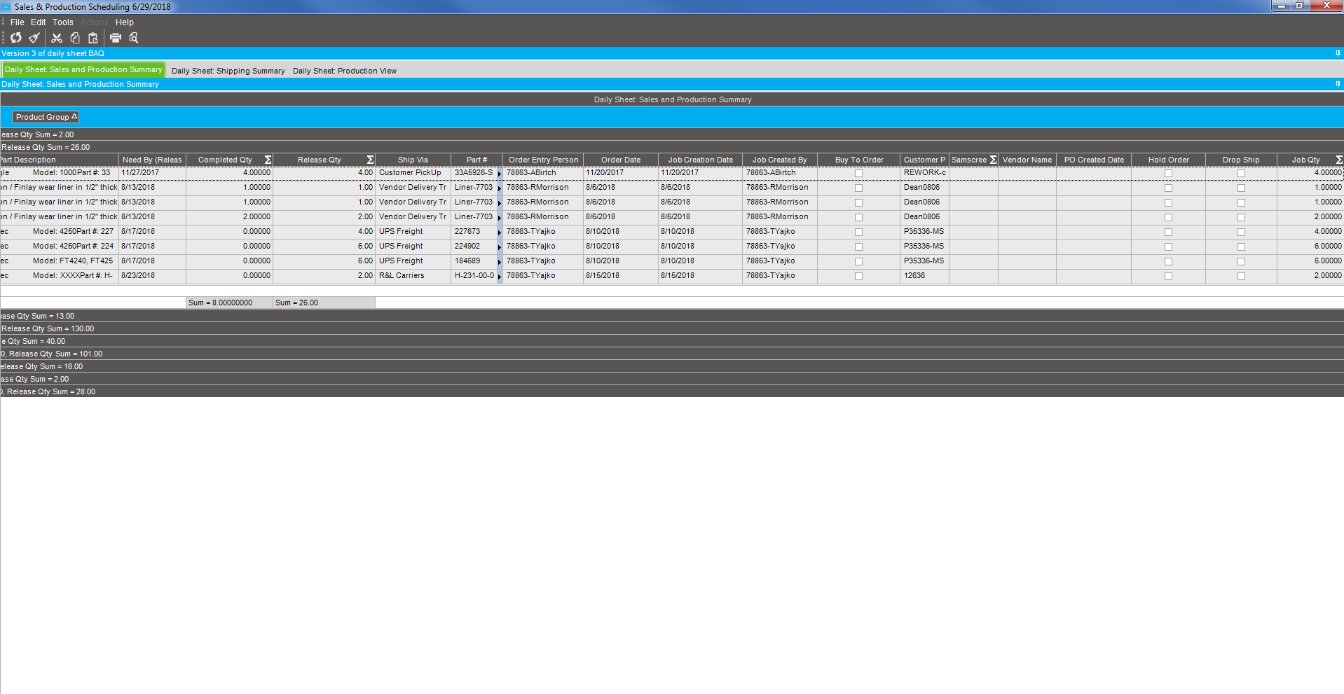

How can I adjust the number of decimals shown on a dashboard? It is not following the format I give in the BAQ.

Can you screenshot the BAQ section showing the mask and also the dashboard how the decimal appears?

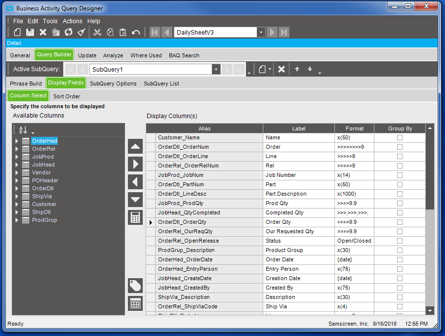

In the BAQ editor, at the bottom of the screen there is a button with a Tag icon. That will open the display attributes editor.
