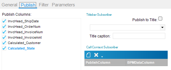

If you open up the properties you can look and see what field is being published for a hint at what it might be.

I looked at the published columns and they are publishing all of the columns in the dashboard.
