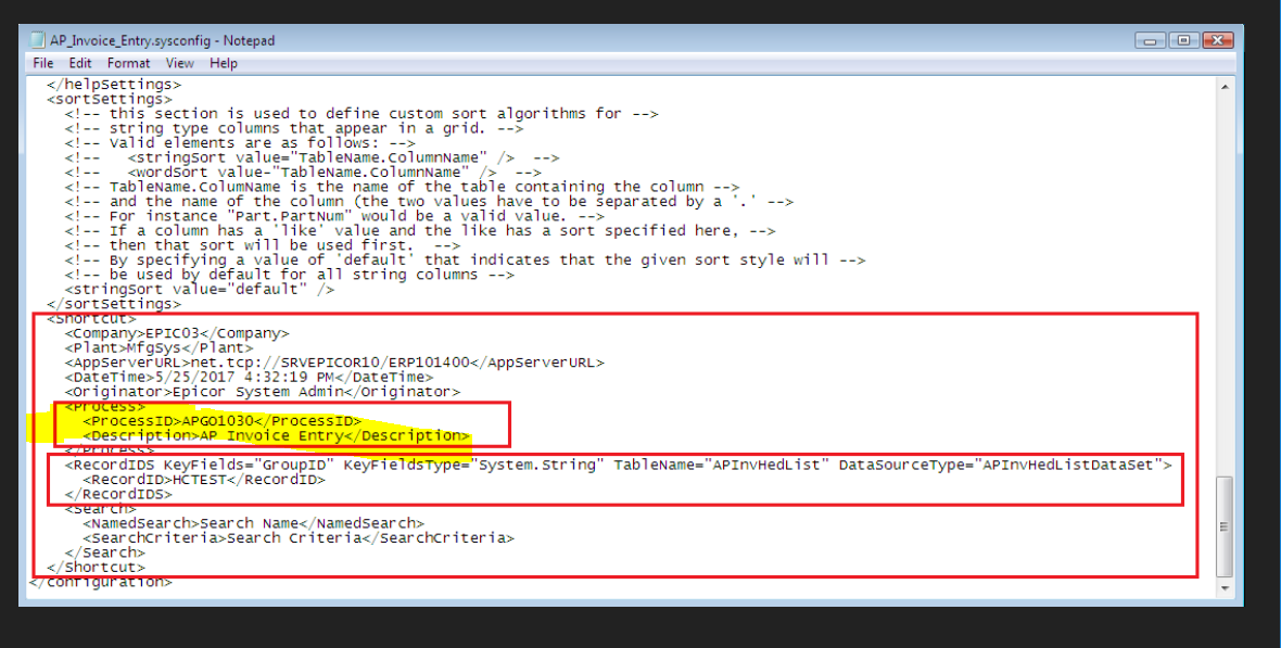

I would like to create a shortcut in the desktop that launches a dashboard.
I tried following this instruction below but it doesn’t launch the final deployed dashboard, but instead launches the preview version…if that makes sense?
What bothers me is that the “Expand group” and “export to excel” functions are not present.
Here is the target I have in the shortcut:
C:\Epico…\Epicor.exe /config=EpicorERP.sysconfig /db /d=“Dashboard_name”
I believe it changed for E10. Go to an EPICOR standard window like job tracker, then got to actions and check the export to file or something like that and that will create the shortcut for that. I guess that will help you get into the right path.
