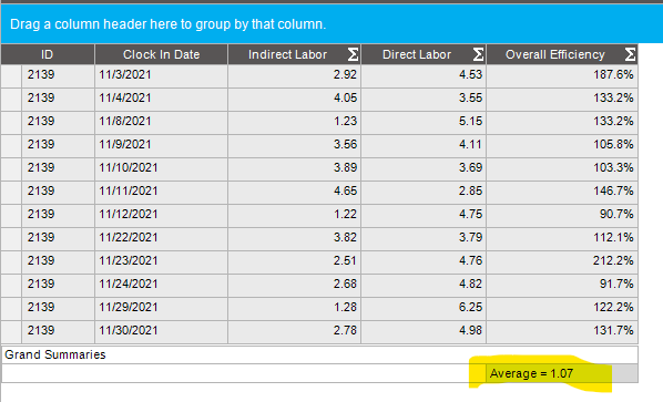

Our users are requesting an average for the ‘Overall Efficiency’ column on a dashboard. Efficiency is displayed as a percentage (format set in BAQ), but the format is not carried through to the summary. I prefer not to tell users that it’s a ‘known issue’. So, is there a way to make this happen?

I suspected that the average of percentages wasn’t statistically valid, so I initially omitted summary on that column. The business wants to see some kind of aggregate, which is understandable.
