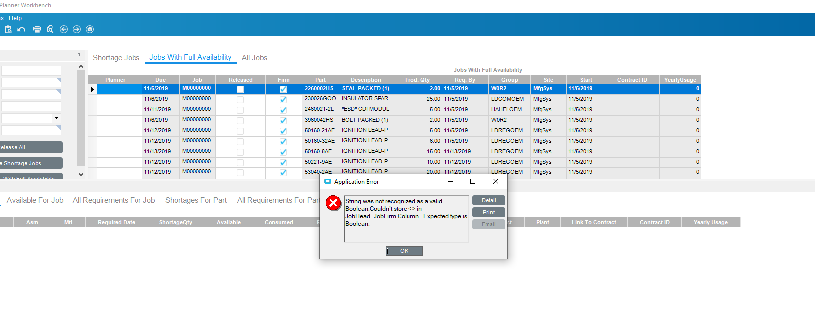

NOW - on to the issue. After these queries were created, I updated the dashboard to use the new queries (I made new queries instead of updating the originals so I could roll back worst case scenario), and everything is displaying as it should. However, whenever I attempt to use any of the button controls to release jobs, I receive the following error:
Error text: “String was not recognized as a valid Boolean. Couldn’t store <> in JobHead_JobFirm Column. Expected type is Boolean”.
Simple error to fix… at least it should be. Debugging in visual studio, the error occurs on the following line in any of the button control click events:
args.Row["JobHead_JobFirm"] = true;

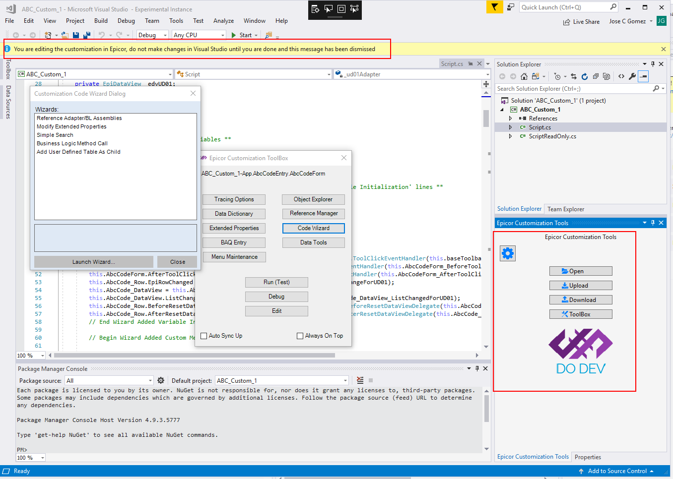

Also, there’s an amazing Visual Studio extension out there that has made my customization debugging so much better. The Epicor “IDE” is fairly lacking…
Oh my word! I’m getting this extension ASAP! Thank you so much!

Yeah that extension is amazing. With that you’ll be able to inspect the data objects while it’s running and hopefully see what the heck is going on here.

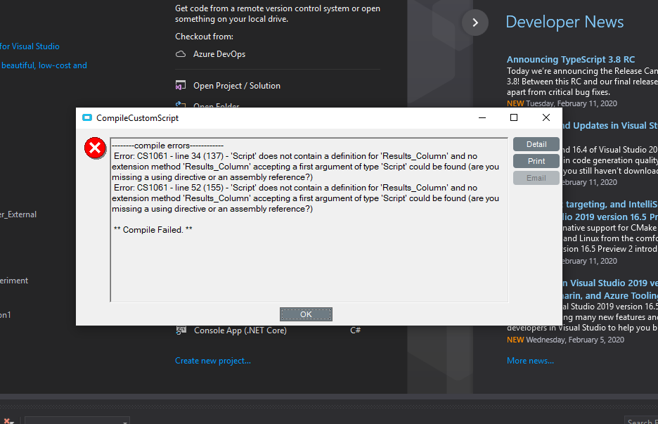

Did you get VS extensions? If you debug with that you can view the value of the object in question while it’s running.
Unfortunately, the VS extension throws errors when I open this customization.
It thinks “this.Results_Column” doesn’t exist. However, I can continue what I have been doing and just debug using visual studio through Epicor.

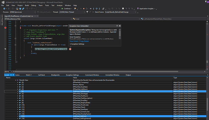

Anyway I digress. Below screenshot is from the results view of args.Row.Table.Columns. If I’m reading this correctly, we know from this that JobHead_JobFirm is Row index 15:

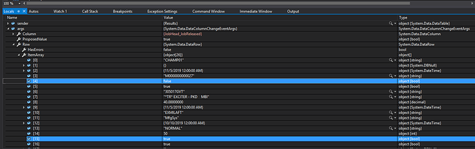

Taking a look at args.Row at index 15, we can see that it is in fact a boolean

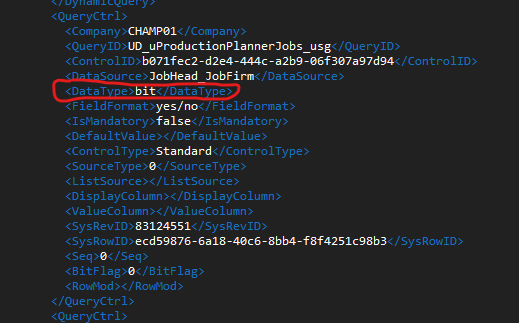

Apologies for the very late response. I got pulled away on other projects and looks like this will be on the back burner for a little while yet. Let me just say thank you Jeff for taking the time to respond. I really do appreciate it :slight_smile:
Running a trace didn’t reveal much unfortunately. The only method that runs is DynamicQueryImpl.FieldValidate() and in this method, JobFirm appears as a bit value which I would assume translates to a boolean though I’m not positive.
Once I get a chance to circle back to this in detail, I will. Thanks again for your responses. Once I do get this working I’ll let you know what I had wrong.
