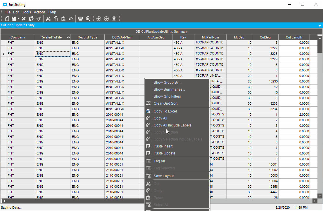

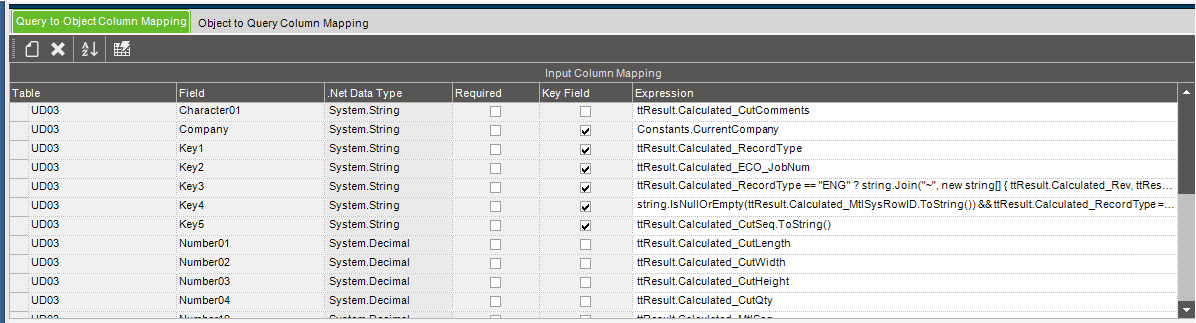

You can also use a Dashboard, UBAQ and UBAQ BPMs and set Calculated_StatusText and RowRules to color the row if needed.
You can get creative with UBAQs as much or as little as you want if you are on-prem.
Few Screenshots of purely using Expressions:
@askulte do it Haso’s way, it’s a lot more self contained

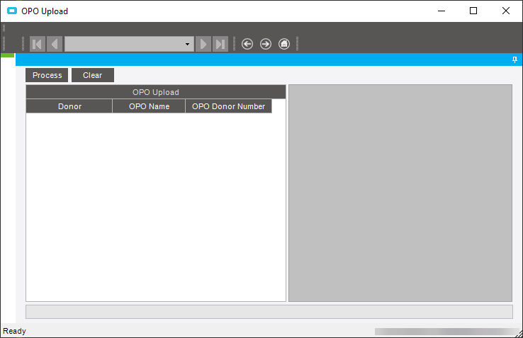

But for cross reference, what I did was use a UD01 form with all the native controls hidden to start.
In this situation, I am going to consume a list of Donor, OPO Name, and OPO Number. Then, I’m going to compare the donor number to any UD100 records where the first 6 characters of Key1 match the input of the Donor. Then, I am going to update each record it finds with the corresponding OPO Name and OPO Number into each of those UD100 records. Then it moves on to the next row in the inputs.

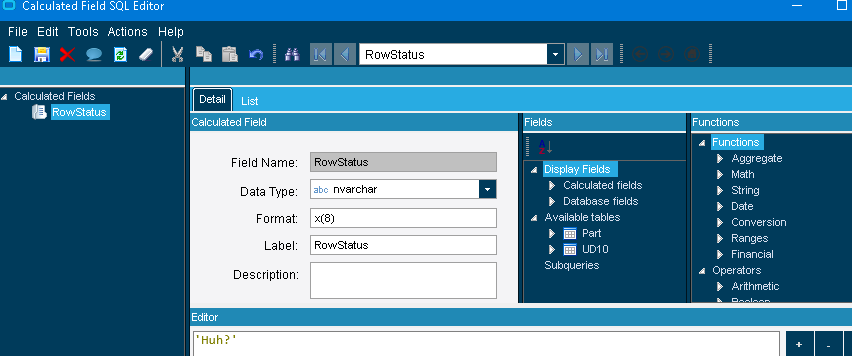

To break this down in smaller steps:

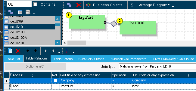

  1. Create a UD Form - How do you create a ud form - #4 by ckrusen. Looking in SSMS, UD10 is the first table without any records. Is there any way to see if it’s being used for other customization to hold temp records, but is empty? I was thinking I could paste-insert the PartNum as Key1 on UD10.
  2. UBAQ, using the open UD10 table to load in the partnum? I’m not sure what I’m updating from the UBAQ if it’s just pulling part records and comparing them.
    2A. Do I use the default UpdateExt BO, or figure out how to attach GetList?
    2B. Which fields need to be updatable, even though I’m not updating part records? Leave “AddNew” unchecked and “Allow Multiple Dirty Rows” checked since I want to parse multiple rows?
2A. Add a calculated field to the UBAQ to show row status?
Enough for now, I’ll get to creating the UD Table form… Thanks again.

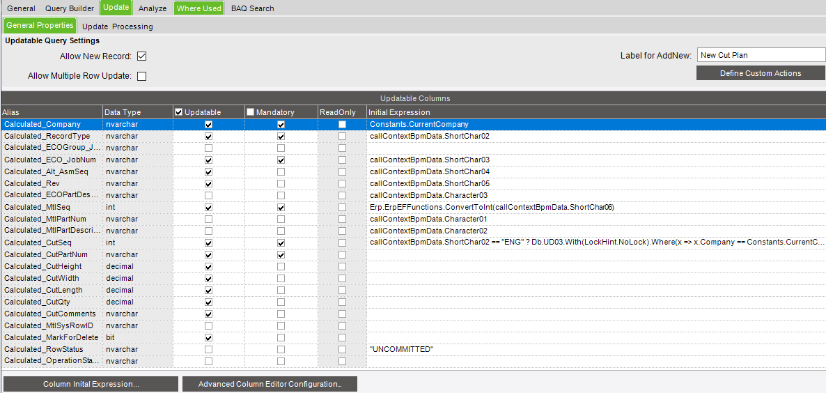

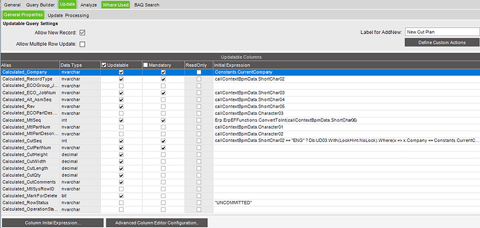

So you wouldn’t create a UD Form, just create a Dashboard-Assembly and you can still customize it later if you need.
For your UBAQ don’t add any tables… create for starters 3 Calculated Fields
Calculated_PartNumSource
Calculated_PartNumTarget
Calculated_RowStatus
Then under the Updatable Tab you can pick “Advanced BPM” and in the Pre-Update you can get the values ttResults table, or you can go to the attribute on the field or is it under Update tab and check the fields to “Raise Events” then you can even use the FieldUpdate and the FieldValidate BPMs in the UBAQ and even validate before the Update, whichever is easier.
Start there, get your UBAQ going

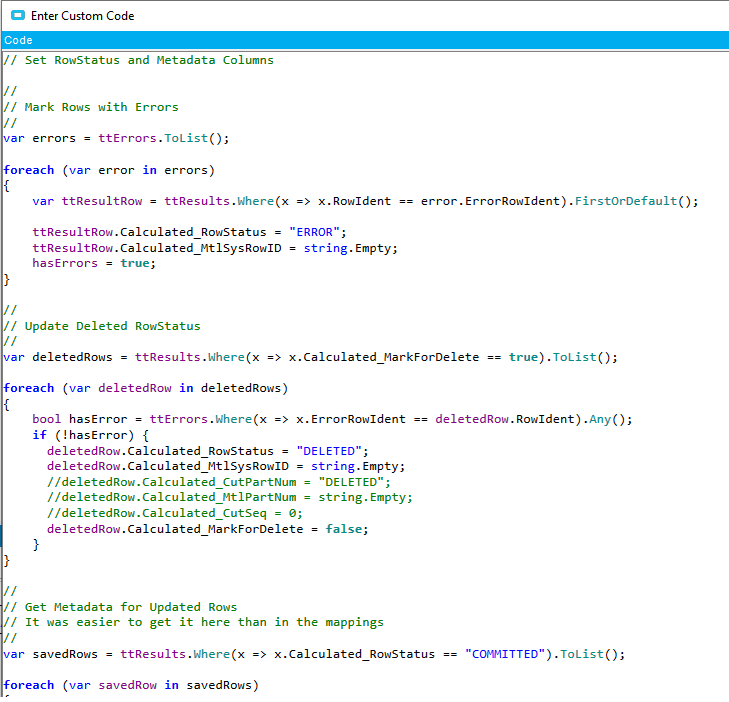

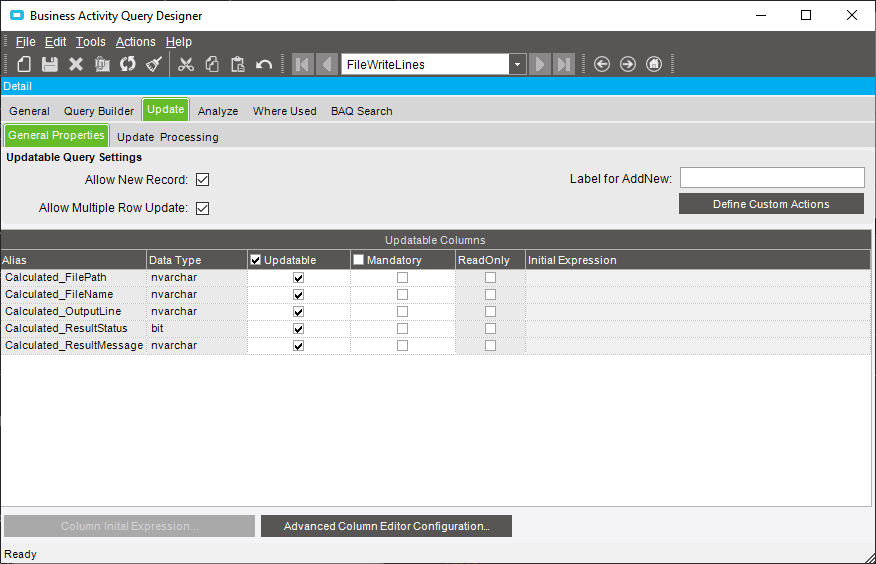

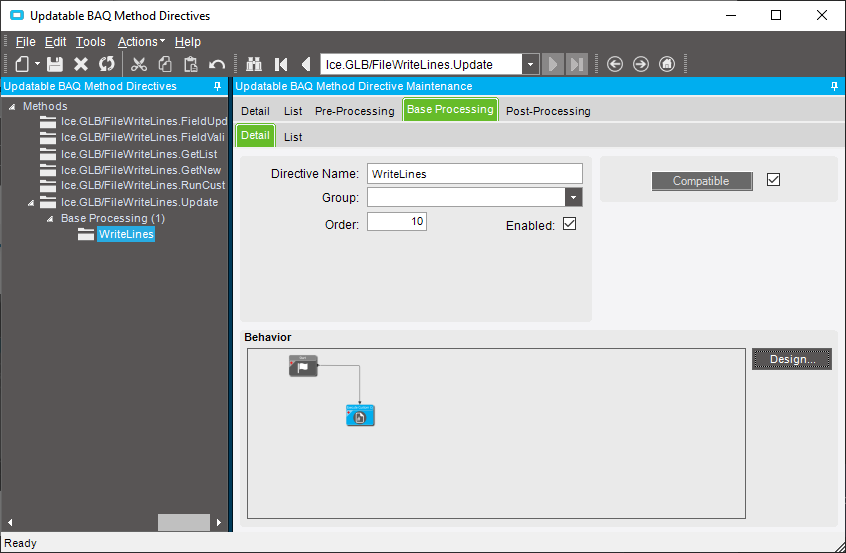

Here is example of a UBAQ I use in Code to write to a UNC Path as the Epicor Service Account. Remember BPMs run server side.
var fileRows = (from tt in ttResults
                where tt.Added()
                select tt).GroupBy(r => new
                    filePath = r.Calculated_FilePath,
                    fileName = r.Calculated_FileName
                }).ToList();
//etc
AKA: Life Before Efx we always just hijacked UBAQs to be functions.

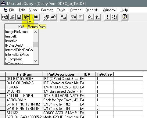

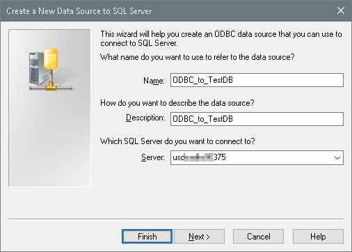

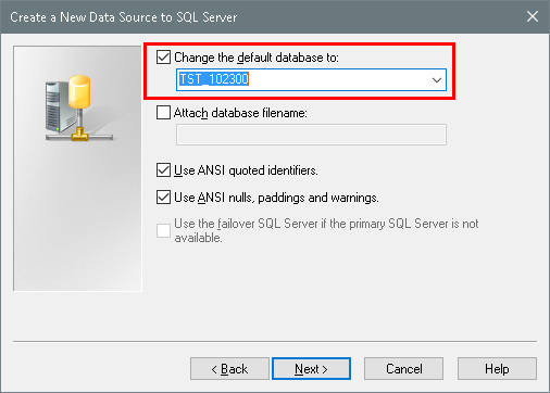

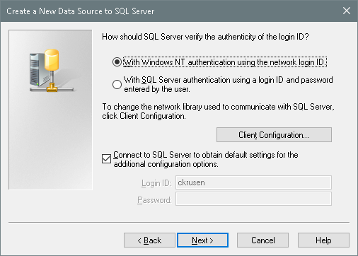

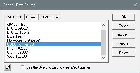

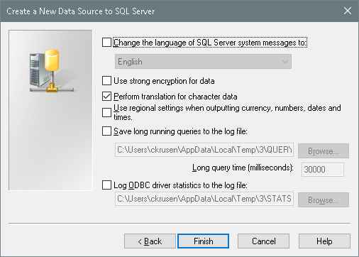

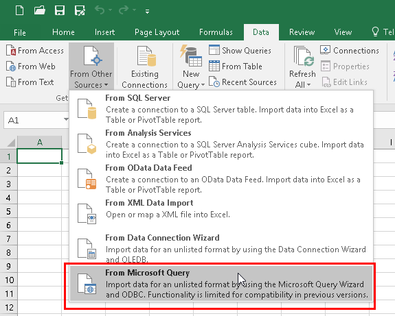

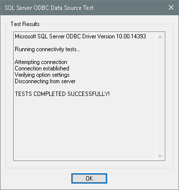

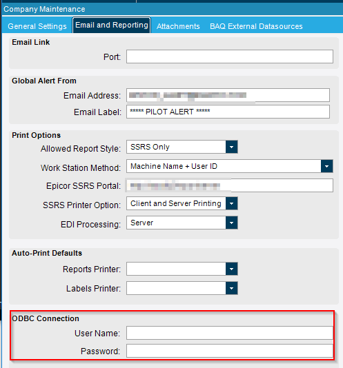

if you’re starting with a list of part numbers to check in excel, you could create an ODBC connection to the SQL DB to populate a sheet with all the part numbers. Then use VLOOKUP() in excel to find the engineering supplied part number in that sheet containing the full list of parts.
And this way the person doing the check doesn’t even need to have access to E10.
If that’s the approach that will be used, why not just bring all parts in via the search box on Part - then export the grid to Excel?
I’m thinking that it’s possible that the OP wants to avoid entering part numbers with syntax differences as new part numbers when they exist already (underscore instead of dash, 0 instead of O, etc.)

My ODBC setting are strictly on the workstations. That area of the Company Maint is for something else.
Here's what I do to add an ODBC connection on a workstation
  1. Launch ODBC Data Sources (32-bit)
  2. Click Add
  3. In the New Data Source window, select SQL Server and hit Next
  4. Give the Connection a name, description and enter the computer name that the SQL server is on. Hit Next.
  5. I don’t change anything in the following window:
  6. In the following window, I set the default Db to the one for the environment. In my example its the name of the DB our Test App uses.
  7. No changes to the deafults on the following:
  8. Now you’ll have the final window. Click the Test Data Source button and you should see:
You can now create a table in Excel, that it linked to that source.
I use:
Then in MS Query, I select the ODBC connection I just made
Make the query, then click Return Data
Excel will ask for a location, and will create a table with the query results.
Refreshing the Part table shouldn’t take more than a few seconds.
Once you add that to an Excel file, it will remember the connection info. So it could a sheet on the template used for generating P/N’s. Then the VLOOKUP could say if the proposed P/N exist, is InActive, or doesn’t exist.
As for being Read Only, That would probably require some setting in the ODBC connection that I glossed over. While there isn’t a straightforward way to write to the DB via the ODBC, you can manually change the SQL phrase in MS Query, to an UPDATE phrase and that seems to execute.
