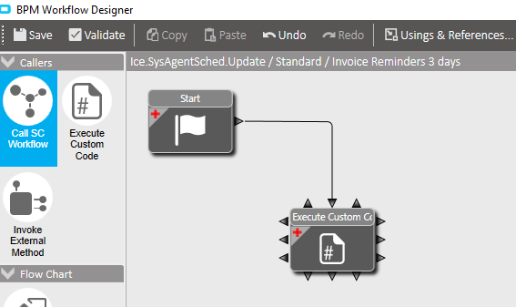

Data Directive 1 to fire off Data Directive 2
I’ve got a Data Directive that runs off the SysAgentSched, it runs each day and checks on the InvcHead table for the due date of the invoice, if the condition is met it sets the AutoPrint Ready field to true
All good so far… this happens

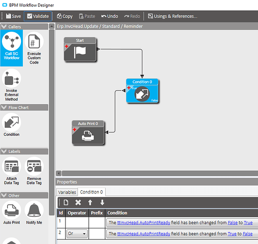

I have a second DataDirective that checks the InvcHead for changes of the AutoPrintReady field and it is meant to run the Auto Print in the directive…
The problem I have is that the second Data Directive doesn’t fire off when the field is set by the first Directive
The second Data Directive will only fire when I manually change the field in the UI

bool tvSYS = ttSysAgentSched.Any(s => s.Updated() && ttSysAgentSched.Any(s1 => s1.Unchanged() && s1.SysRowID == s.SysRowID && s1.LastRunOn != s.LastRunOn && s.AgentSchedNum == 194922));
if (tvSYS == true)
///Date in 3 days time
var fud = DateTime.Today.AddDays(3);
var invs = Db.InvcHead.Where(i => i.Company == Session.CompanyID && i.OpenInvoice == true && i.CreditMemo == false && i.UnappliedCash == false && i.DueDate == fud).ToList();
if(invs != null)
foreach(var inv in invs)
var send = inv.AutoPrintReady;
if(!send)
inv.AutoPrintReady = true;
Db.Validate();
if(send)
inv.AutoPrintReady = false;
Db.Validate();
Second Data Directive
Data Directives are fired off an internal trigger which doesn’t always fire when you bypass the business object and write directly to the table (like you are doing in your first Data Directive)
You should use the Business Object to make that update if you want the secondary DD to trigger.
Particularly the field changed from x to y triggers need a BI (Before Image) which only comes from the BO (or if its manually created)

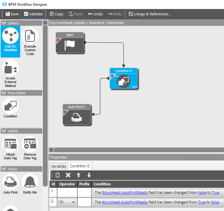

I have a feeling doing a manual click and save is different than the system changing the field. I would maybe try method directive for the 2nd one.

I bet you can use a condition and check for field change with the UI buttons instead of C#, if you’re just printing.
@kylepbsps That’s what I’m doing in the second DD

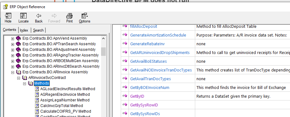

I think what @josecgomez is meaning is to use the following:
using (var svcARInvoice = Ice.Assemblies.ServiceRenderer.GetService<Erp.Contracts.ARInvoiceSvcContract>(Db) )
along with the methods GetByID (to get the invoice dataset) and UpdateMaster (to update based on the dataset)

Right this was meant to be an example of how to calla business object not the exact one just how to do it. Like @AndrewM said.
