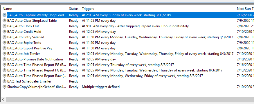

I would not recommend this method at all. You can still do a scheduled task using a BAQ at 500 (which it appears you are on from your user card) by just adding the code you need to the GetList method of a UBAQ and scheduling it. Don’t mess with system task tables. Once you are on 600 you can schedule an Epicor Function and take the BAQ part out of it too and truly write your own process. I don’t recall that might even be available on 500 (but not likely)
Oh, that’s interesting. I saw the same GingerHelp article a bit ago and have used this a few times to schedule things. I’m on 10.2.100 and figured seeing I was reading only it was ok.
What do you figure are the downsides?
Write some bad logic and you bring down printing, mrp, the whole sheebang vs one BAQ. When troubleshooting isolation is your friend. You’re on an older version would be relegated to this method or a custom program to fire off BAQs from windows task scheduling using BOs (this is how we did it back then a lot of which have not been converted yet)

I updated everything to a scheduled UBAQ using the GetList directive as suggested, and now it all works as desired. Thanks for the help!
