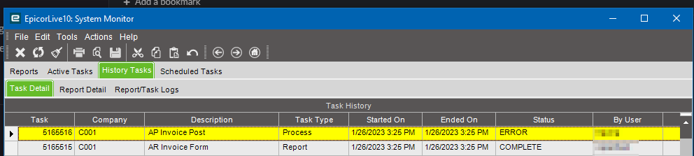

Are you seeing it show up in the system monitor? (with an error)
Thanks for looking in to it. I am going to make the BPM ignore indirect, and filter out indirect on the BAQ. Maybe that will help things move in the right direction.
I do, and the error shows “No record selected”. From what @Asz0ka said that could be the indirect labor records not having a job number.
