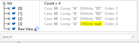

Here is an example in VS. I faked some classes to emulate Db.orderHed, OrderDtl, but it works the same. Note that I had to DefaultOrEmpty to an a new blank object of the type (Dtl in this case)
     class Header
            public string Company;
            public int OrderNum;
            public int HDCaseNum;
        class Dtl
            public string DtlNote;
        class aDb
           public List<Header> OrderHed;
           public List<Dtl> OrderDtl;
           public aDb(){
                 OrderHed = new List<Header>();
                 OrderDtl = new List<Dtl>();
        private void button2_Click(object sender, EventArgs e)
        aDb Db = new aDb();
            Header h1 = new Header() { Company = "A", OrderNum = 1, HDCaseNum = 69 };
            Dtl d1 = new Dtl() { Company = "A", OrderNum = 1, DtlNote = "D1"};
            Dtl d2 = new Dtl() { Company = "A", OrderNum = 1, DtlNote = "D2" };
            Header h2 = new Header() { Company = "A", OrderNum = 2, HDCaseNum = 69 };
            Dtl d3 = new Dtl() { Company = "A", OrderNum = 2, DtlNote = "D3" };
            //Dtl d4 = new Dtl { Company = "A", OrderNum = 2, DtlNote = "D4" }();
            Header h3 = new Header() { Company = "A", OrderNum = 3, HDCaseNum = 69 };
            Db.OrderHed.Add(h1);
            Db.OrderHed.Add(h2);
            Db.OrderHed.Add(h3);
            Db.OrderDtl.Add(d1);
            Db.OrderDtl.Add(d2);
            Db.OrderDtl.Add(d3);
            /* Start new code */
            var OrderHedVar = (from o in Db.OrderHed.Where(o => o.Company == "A" && o.HDCaseNum == 69) //this would be TaskList.Company, HDCasenum
                                   // *** Add left outer join to OrderDtl
                               join od in Db.OrderDtl
                                on new { o.Company, o.OrderNum } equals new { od.Company, od.OrderNum }
                               into oodj
                               from joins in oodj.DefaultIfEmpty(new Dtl())
                               select new
                                  Comp = o.Company,
                                  Order = o.OrderNum,
                                  Case = o.HDCaseNum,
                                  DtlNote = joins.DtlNote
           var list = OrderHedVar.ToList();
            // end new code
Note that Header3 had no detail

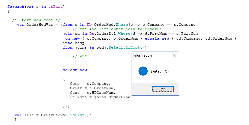

Im confused, works for me. What version?
Epicor 10.1.400.17. The error occurs after I exit from the C# editor and save from the Method Directives Maintenance screen.
