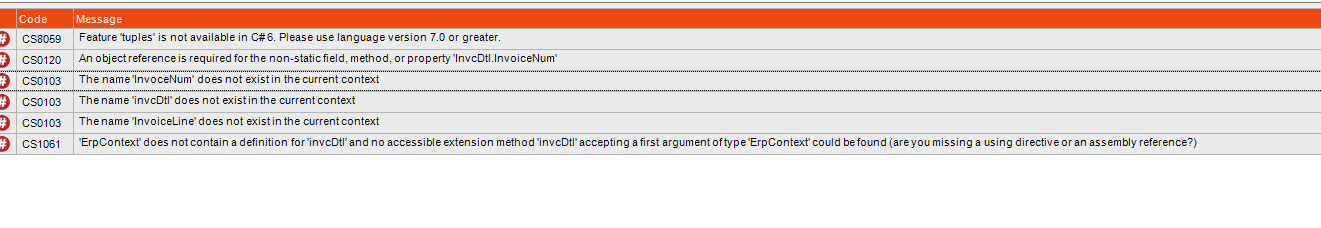

Most of those errors are because of case sensitivity. You might want to check those first and then it’ll look a lot more manageable.

System.Drawing.Bitmap	CS0120	An object reference is required for the non-static field, method, or property 'InvcDtl.TotalFreight_c'

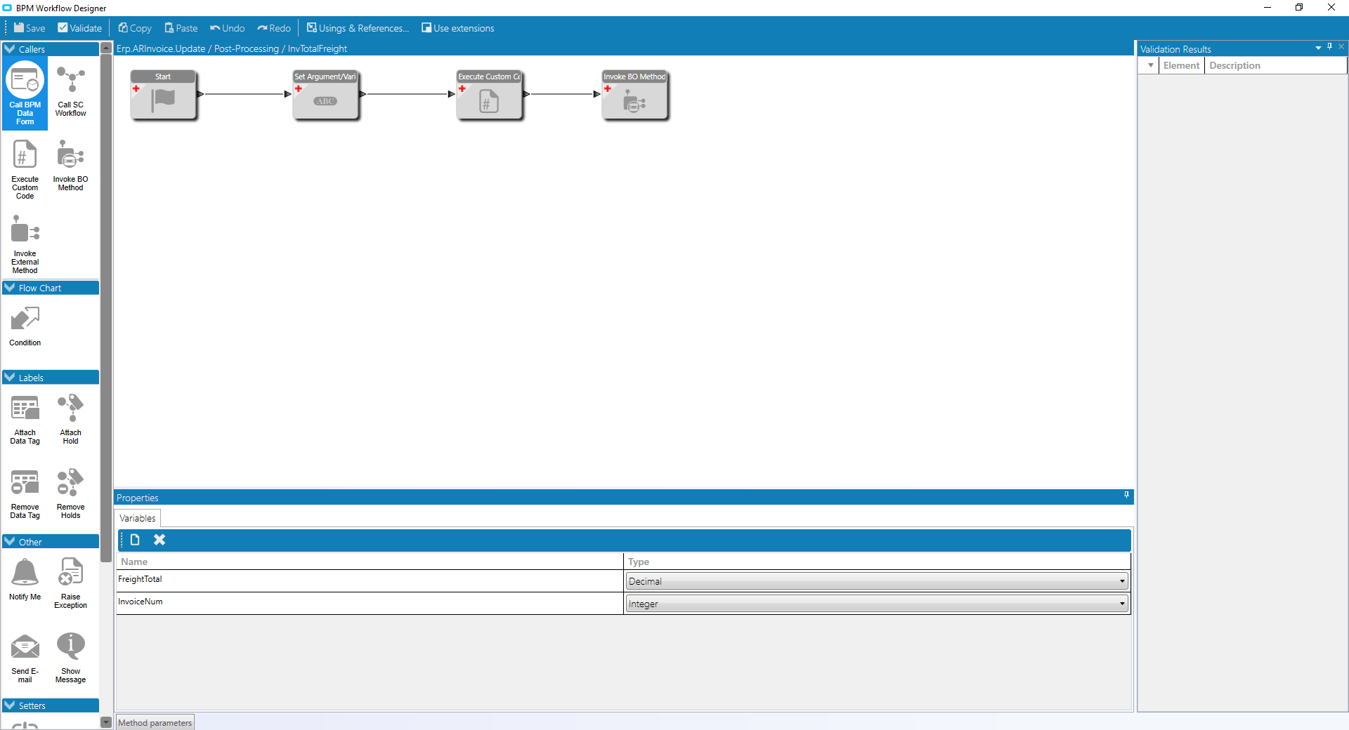

Just copying, pasting, and tweaking, does this work better?
var FreightTotal = (from invcDtl in Db.InvcDtl
                   where invcDtl.InvoiceNum == InvoiceNum
                   select invcDtl.DocTotalMiscCharge
                   ).Sum();
using (var txScope = IceContext.CreateDefaultTransactionScope())
  foreach (var invcDtl in (from InvcDtlRow in Db.InvcDtl
    where InvcDtlRow.Company == Session.CompanyID && InvcDtlRow.InvoiceNum == InvoiceNum
      select InvcDtlRow))
        invcDtl["TotalFreight_c"] = FreightTotal;
 Db.Validate();
 txScope.Complete();
It grabs the invoice number and totals all of the lines ending in one single Freight Charge calculating all of the lines Misc Charges.

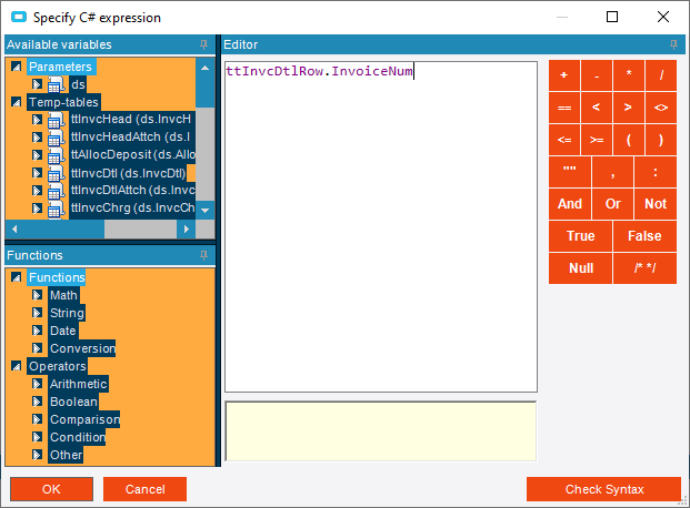

I’m setting it in a ABC under a variable InvoiceNum
Over to @aarong on that. It’s just a slightly altered version of his code, and I assumed there was more of it and InvoiceNum was already a set variable.
Few changes I would do:
I would use UpdateMaster and then you will have access to a built in pre-populated variable ipInvoiceNum, ipInvoiceLine, cTableName, cGroupID
The reason yours does not work probably is that you must be updating InvcDtl for the ttInvcDtlRow to have something populated, if you update a Misc Charge the BPM would only have ttInvcChrg or so.
