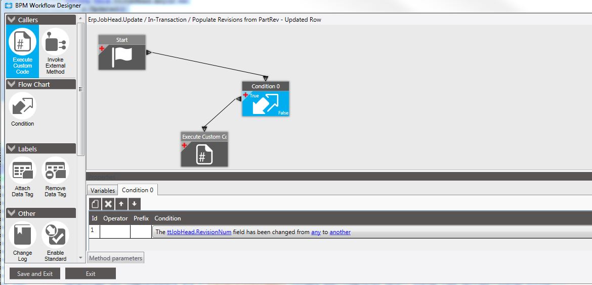

you can always see what Epicor does for its conditional check. Use that code as an example like below.
\EpicorServer\c$\inetpub\wwwroot\Live101400\Server\BPM\Sources\DT\ERP.JobHead.Triggers\43
Which equals: It might save you a few lines in your code.
