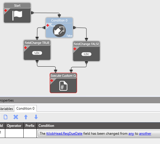

Does the Condition Widget not do the same thing? Even if it does the check and then sets a variable before the Exec Custom Code widget?
yes, It DOES do the same thing… The challenge is that if you have 10 values you are checking for, this would get VERY cluttered with widgets. If it is just one value, the widget based code would be better.

For the record, I also prefer writing code to widgets usually… But to be fair, if you have 10 different fields you don’t need 10 condition widgets, just the one with 10 conditions with Or operators between them. The way I see it, if you’re gonna use a code block anyway, might as well put the condition in there so everything is in the same place…
