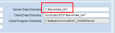

@BillCox - Do you update the sysagent settings after copying Live to Test?
If you do, you can test for that by making a query type Condition widget, checking the SysAgent table where the FileRootDir contains text from your Test environments Server Ddata Directory setting.
Note that the FileRootDir field contains both the Server Data Directory and the Client Data Directory values separated by a comma. Like: \\usdcaaps00371\EpicorData_UAT,C:\EpicorData_UAT, That ends with a comma, so there might be a third bit in your system.
