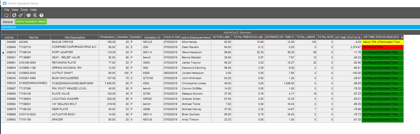

just an idea i have done if you are interested in highlighting such transactions, which is creating a BAQ/dashboard refreshed each minute for active labor transaction with calculated field to count the difference between current time and clock in time and add this to the total of any previous transaction times (subquery) then compare that to the estimated time for production/setup transactions
