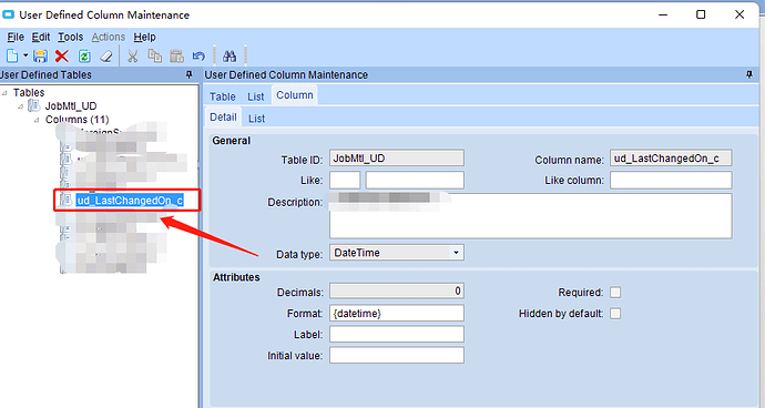

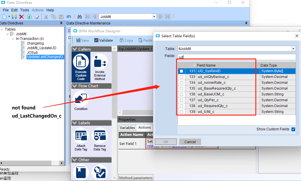

Data Directives Can't find New Add UD
What shows in the field select box if you don’t enter the filter ‘ud’, and just scroll to the bottom?

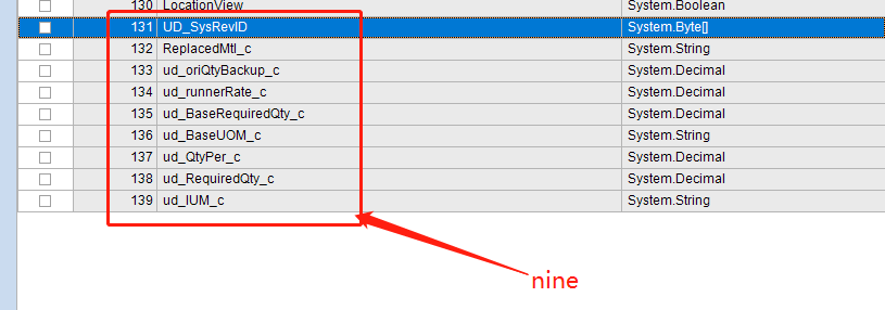

It looks like there 9 UD columns (11, minus SysRow and SysRev) but only 7 show in the field select dialog box.
05
safe to assume that the missing one was the last one added, and would be #140?

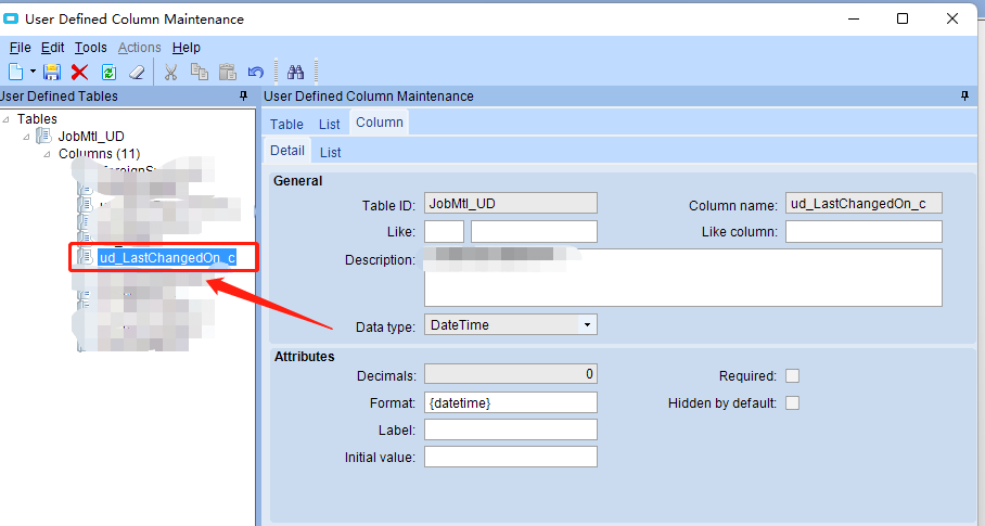

Have you tried regenerating the DB again?
