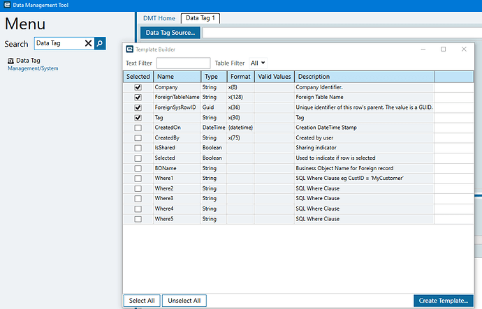

Can you DMT the data tag onto the affected Jobs?
Set a tag on a job manually, and see how it looks in the SysTag table. Then copy the format for the DMT upload.
If it’s a one and done, that saves creating UD fields, populating tables, etc…
