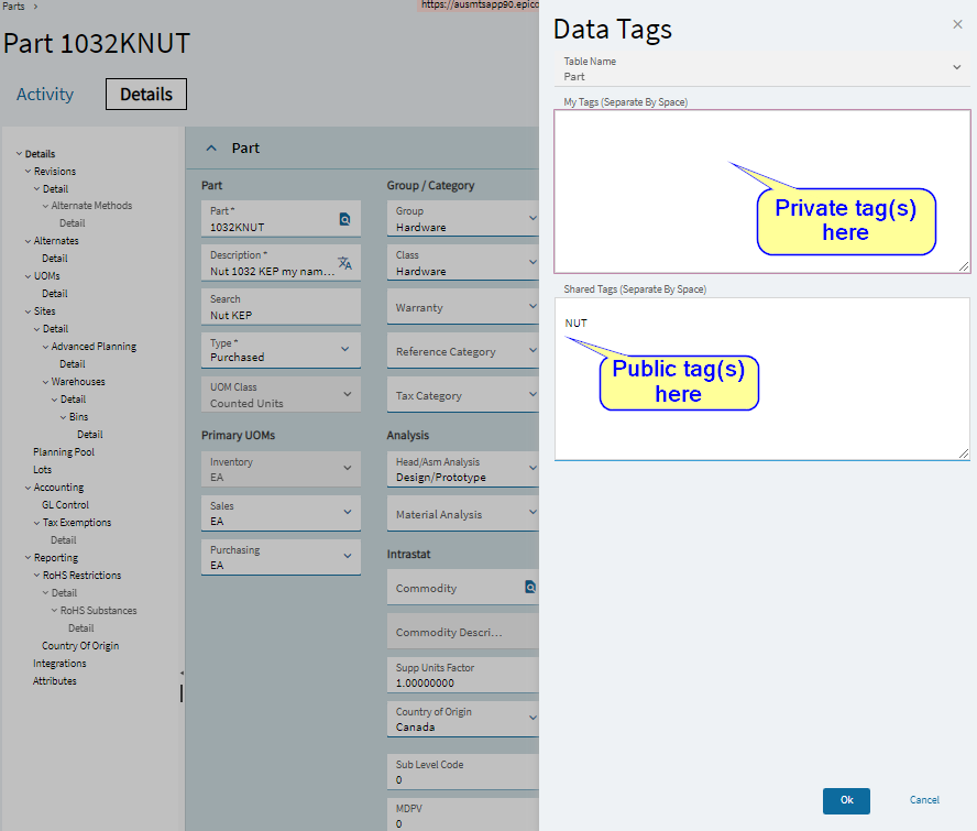

DataTags could be used to classify parts/customers/orders… i have seen customers add multiple data tags on each part to help classify them (see screenshot below). Classify Customers into different groupings. An example of Parts… go into every part that is a NUT, and tag it with NUT… then when you search for NUT, you will find them all (even if NUT is not part of the description).

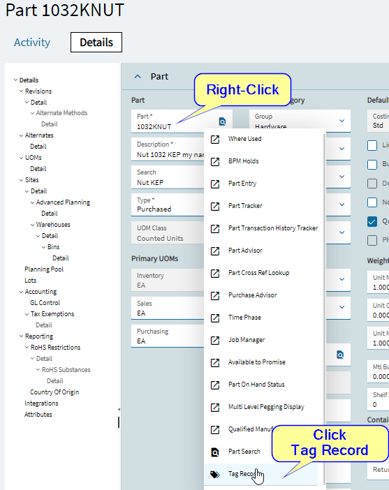

So… how do you add a tag? Go into ANY screen, and right-click on the primary field (customer ID, Part, Order#, PO#, etc)… choose Tag Record:
Then add (or remove) your tags:

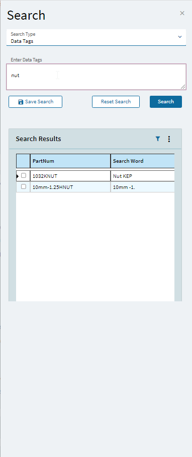

To SEARCH for tags… press the search button and then choose Search… then choose the search type “Data Tags” and enter the tags you want to search for (note that if you search for multiple tags, this returns an “or” search).

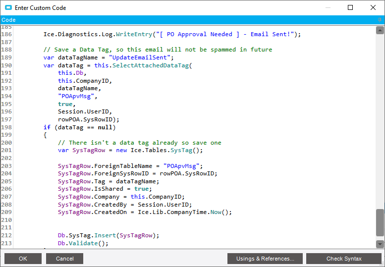

We use it currently for POApvMsg to make sure we don’t spam the user if they already received an email (Approver, User, Buyer).
