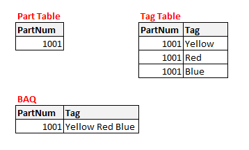

I can’t figure out a good way to do this since each data tag is on a separate row in the SysTag table. If I want my BAQ to pick up all these records, then when the search is not performed on the data tag (say on PartNum) it will return multiple records for each part ( if there are multiple tags for that part).
Has anyone incorporated these into a quick search and if so, how.
Or, does anyone know if it is possible to add a field to a BAQ that would concatenate all of the records from a child table? Then, I could just search on that field. Something like this…

How do you get to the resulting record you have from a BAQ without changing the table structure? I would think I can just do a calculated field to combine all of those values if I had that as my record, but I can’t get to the point of having one record return per part with essentially an array of values from the child (tag) table.

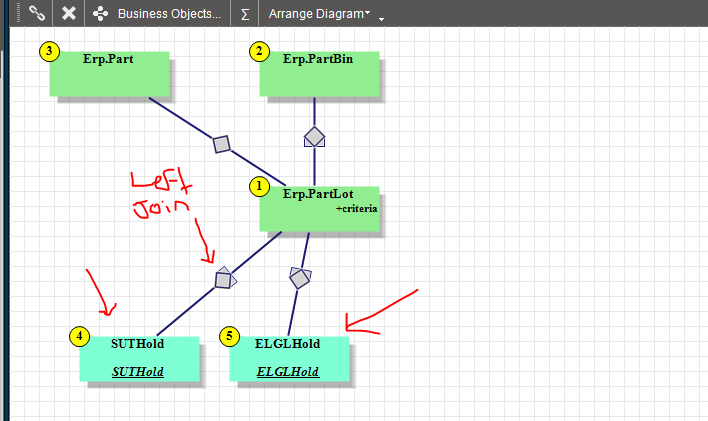

As an example, I do something similar to display BP Holds on records. For each Part Lot in this example, I am returning a value from a subquery where it exists.

So basically, you will have your top level query with Part as the first table. You will need 5 subqueries. Your first inner subquery will be the SysTag table. On that table, you will put a table criteria to be your first condition, which will be whatever field you are storing “Red” in (or whatever). In this subquery, you will display the column that holds the value of the data tag AND also display the ForeignSysRowID.
For each different possible column, you will want to create a new subquery and do the same thing as above, just filtering each one by that criteria.
When all that is done, on your top level query, bring in each subquery you created. Join them to the part table via left join on ForeignSysRowID to Part.SysRowID. Then, display the PartNum and from each subquery, the column that describes the data tag.
You will then have a single row per part and if the part has a data tag, it will display in the proper column.
