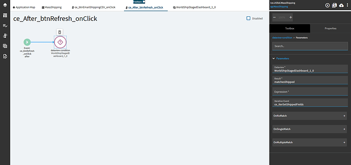

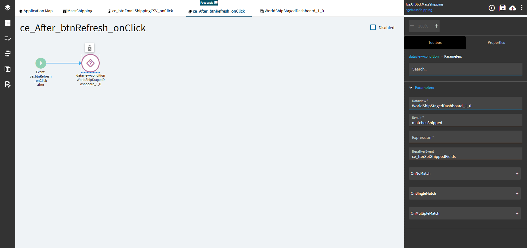

I don’t know who needs to see this, but if you want to iterate on all rows using a dataview-condition widget in App Studio, it turns out you can just leave the expression field blank. :woman_shrugging:
I’ve always just put in some expression that I know will equate to True but leaving it blank is much easier and more effective.
The More You Know Fun GIF by megan lockhart
It’s funny that I read this RIGHT after I saw an older post of yours where you said you put 1=1 in there just to give it something true.
