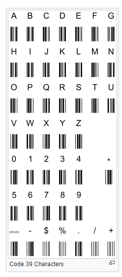

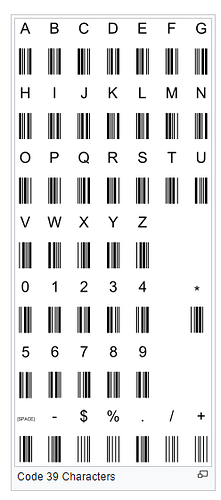

the code39 barcode has a VERY limited set of barcode values… see Code 39 - Wikipedia for more information. That is what is in the Dataworks barcode font.

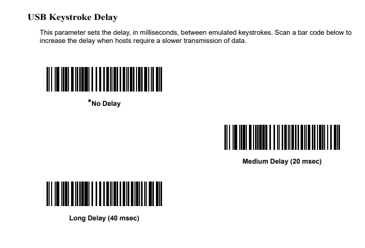

Adding a delay usually won’t require software. Most scanners have specific barcodes to add a delay right in the user manual. This is from the manual for the LS2208 for example:
Thanks everyone for the great replies!!! However, I need a delay between two Enters… Like scan, tab, tab, enter, enter. When I code the two Enters, it moves too fast for the scanner.
