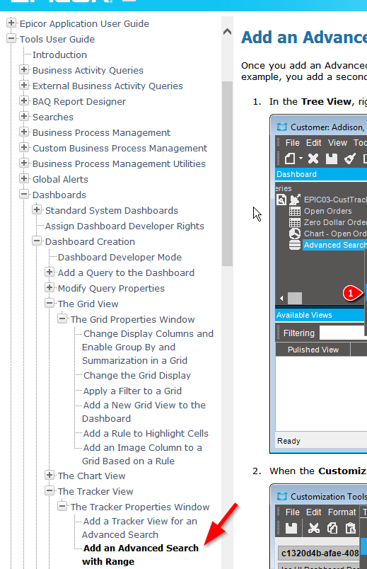

Also, check out the tools guide. It walks you through how to add a range to a tracker.
Or in the help files.
