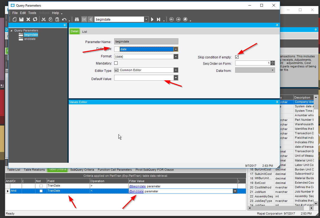

You can add parameters for filtering out the BAQ based on date range. Just make one greater than, one less than, and filter in the query that you are using to add up the dollars. Every time you refresh in the dashboard you will need to pick dates.

Then use the paramaters in the BAQ. They have to put the date range in when they refresh, but if they know what they want, it’s not a big deal.
See screen shots below to set it up. I used a different table, but you get the idea. two filters, less and greater than, by specified parameter. Then set the parameter options as shown (I like to use skip if empty so it grabs everything, and if you want to can set a default that will populate when the parameter comes up). Then when you test the BAQ, you get the date range pop up. The same thing will happen in the dashboard.

Unfortunately the tracker view can only filter the data coming from the BAQ (without some custom work anyways) so grouping and summing without using the grid functions isn’t possible (easily).
Since the parameter sends the info in before the BAQ is processed, it allows more things to be possible.
