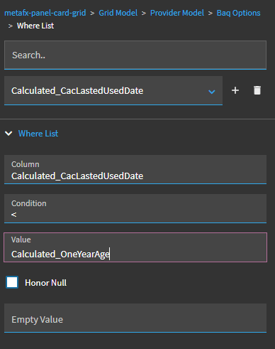

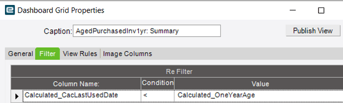

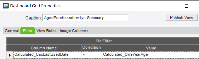

The Classic dashboard filtered on Calculated_CacLastUsedDate < Calculated_OneYearAge
When I uplift the dashboard, it comes into Kinetic Application Studio
I think the issue is that the value is incorrect. The value needs to be one year ago from today’s date.
I can make it work with Calculated_CacLastUsedDate < ‘11/15/2023’

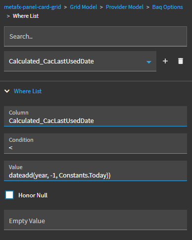

Now I am trying to replace the ‘11/15/2023’ with an expression instead. I have tried:
dateadd(year, -1, Constants.Today))
Date.getFullYear() - 1
Date.getDate() - 365
currentDate.getFullYear()-1
Please suggest the correct value for 1 year ago.

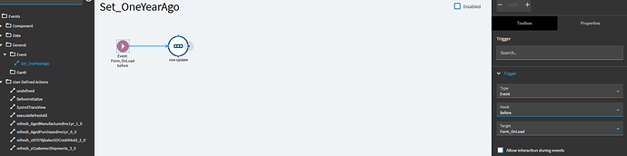

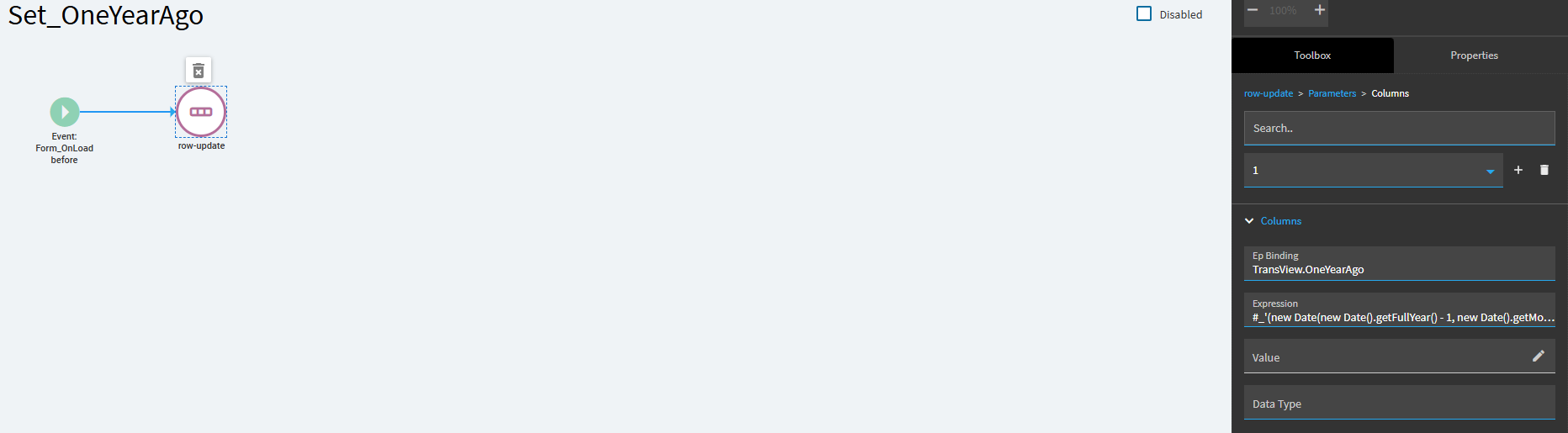

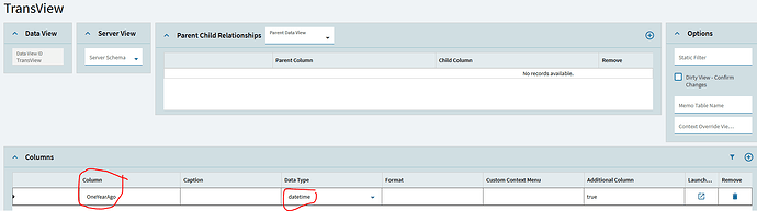

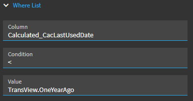

If I understand correctly, I created a TransView variable called OneYearAgo.
Then I created a New Event under General. The new event has a hook before the Form_OnLoad. After the event trigger, I have the row update.
Then I filter on the TransView.OneYearAgo
If the value is TransView.OneYearAgo then it returns no records.
If the value is ??{TransView.OneYearAgo} then it returns all rows.
How do I check that I actually was able to set the TransView.OneYearAgo variable and identify its value? My best guess is that I have created the event incorrectly and I am not setting my date value.

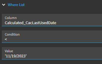

If I set the value in the Where List to ‘11/18/2023’ (a string) then the filter works on the Where List.

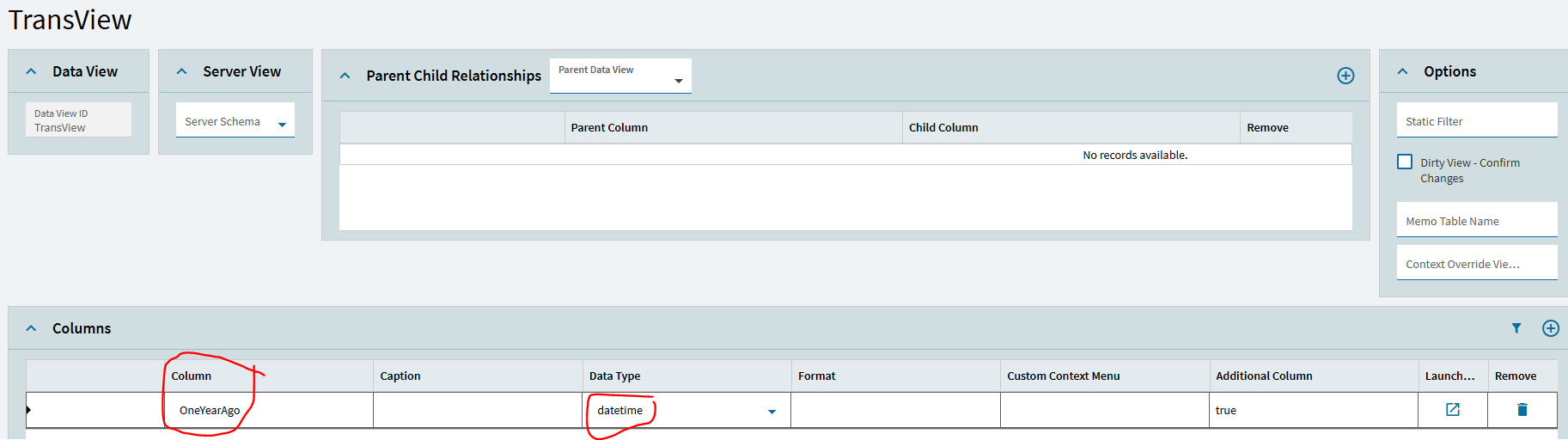

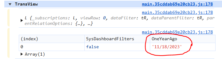

I created a TransView.OneYearAgo and made the TransView a DateTime datatype. The BAQ has a data format. I used the expression to define the OneYearAgo variable and it is returning
That is a match for what was working. But the TransView variable returns no records.
I have tried to change the TransView variable to a string instead of DateTime. I have tried {} and or () brackets. Based on the OneYearAgo variable coming back as a match for what works, I am guessing that my error has something to do with format and syntax.

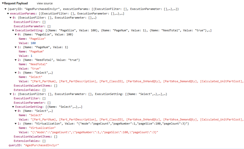

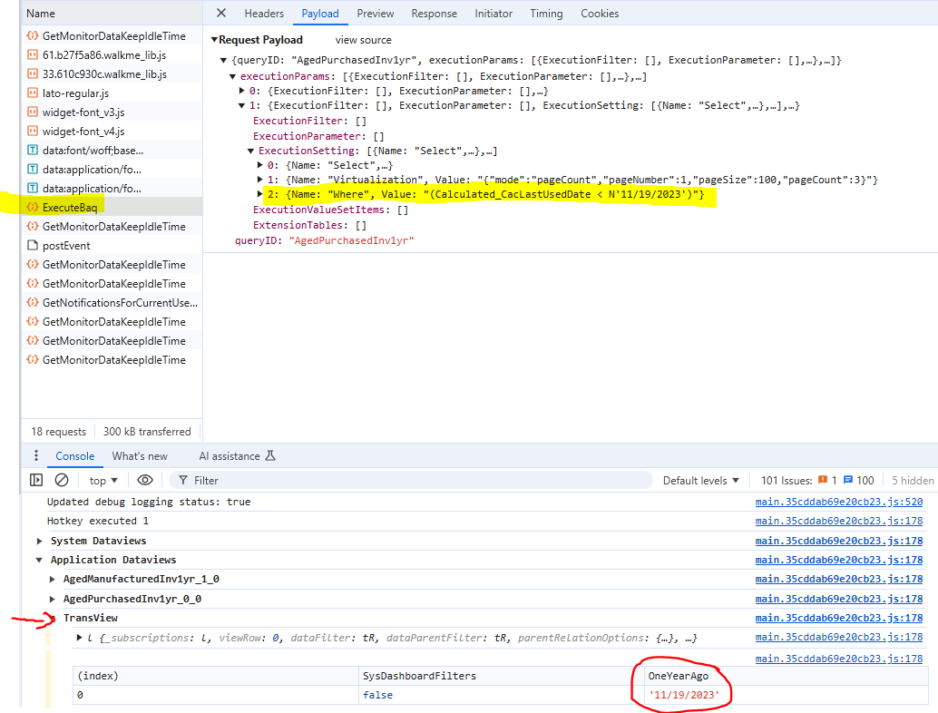

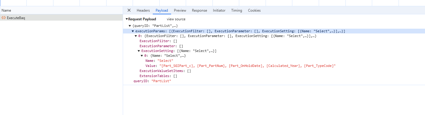

Look at the payload on the network tab of Developer Tools so you can see exactly what it’s sending to the BAQ.
You should see something like this, but with a Where Clause in there.

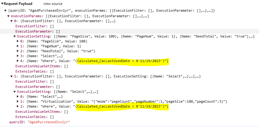

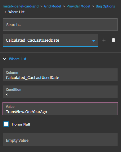

The where list in application studio looks like this:
The payload for that where list results in:
This gives me no records returned.
I want to compare what is working to what is not working.
When I just use the date in the Where List then I get the correct rows returned.
This is the working Where List with ‘11/19/2023’
This is the payload that it returns

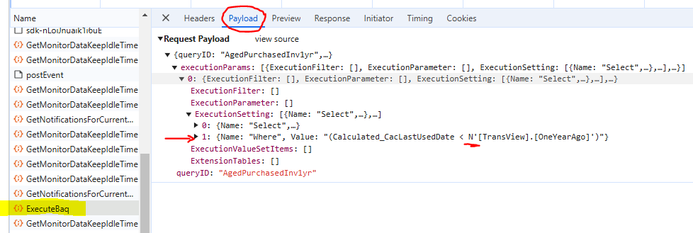

Change it to ??{TransView.OneYearAgo} and look at that same network call.

In the Where List I made the value ??{TransView.OneYearAgo}
It returns all rows and this is the Payload
I can’t find the Where statement any longer in the Payload. The screen shot is the entire Payload.
Try it with single quotes wrapping it:
'??{TransView.OneYearAgo}'
I put single quotes wrapping it.
It worked. It returns the correct rows and the where statement is back in the Payload.
Notice that the working Payload has replaced transview variable with the date.
