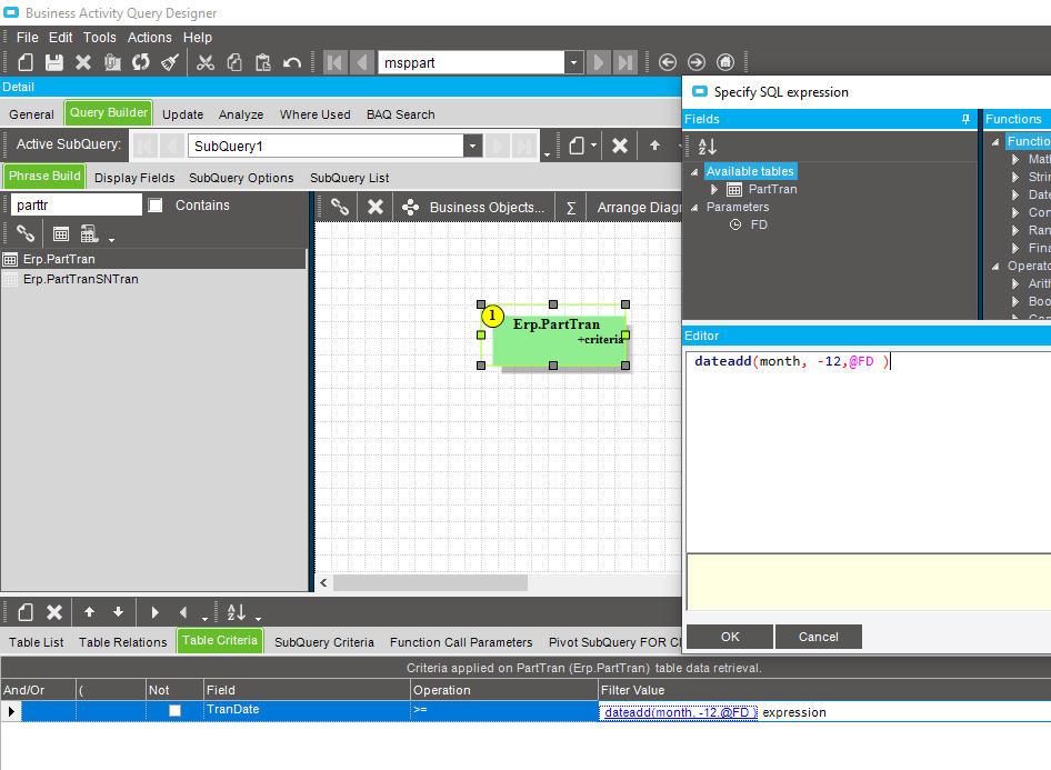

I am creating an Inventory Usage BAQ and would like the user to be able to enter the Through Date much like they do in the printed report. To accomplish this I though it would be very simple to use a parameter where needed.
For some reason, I keep getting the error “Invalid parameter 1 specified for dateadd.” I believe this is correct SQL syntax so I really do not understand why this would not work. Does anyone know why this is occurring? Can I not use it in the expression editor like this?
I was originally using the “Current date -12 months” value which shows as ‘dateadd(month, -12, Constants:Today)’ or something similar to that in the query. I would like it to be the same thing but instead of using the today constant, I would like to have the user enter in the date they would like.

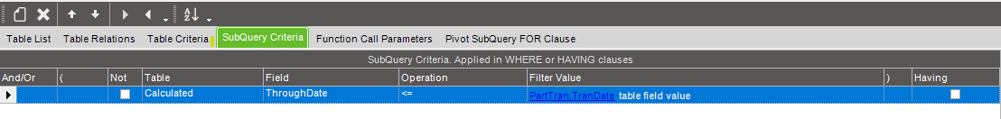

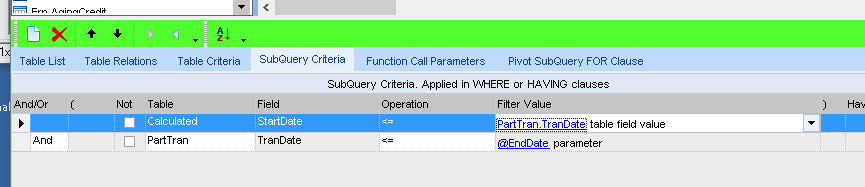

Try creating a Calc field using the same formula, then use the calf field in a Sub Query Criteria (not to be confused with a Table Criteria)

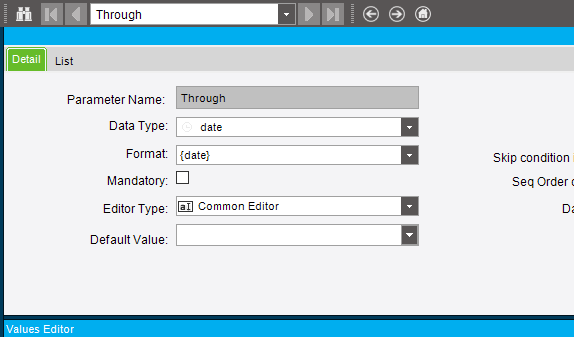

Syntax is correct. May be cross check again the data type parameter used. It should be “{date}”
It doesnt seem to work that way either, Calvin. Same error.
@prash172 I double checked and the parameter is date type.

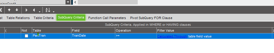

Change it to test if the Calc field is <= to PartTran.TranDate

Still no go. Now getting errors “Invalid parameter 1 specified for dateadd.
Incorrect syntax near ‘)’.”

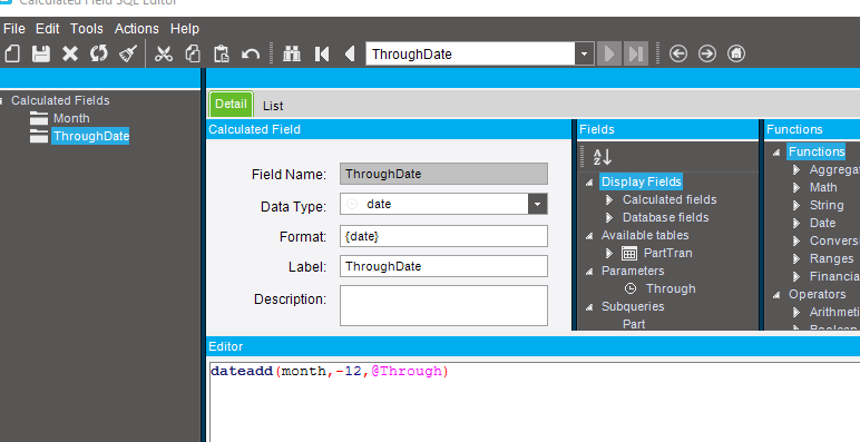

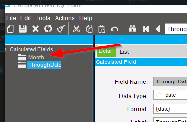

Check the formula for the Month calc field. And “Month” may be a reserved word. Try changing it to Mon (you’ll have to delete it and create a new one)
In SQL you can use month, mm
I usually stick with the mm to make sure I don’t conflict with any functions.
I was referring to the name of the calculated field he made:
I know. I was just stating my personal preference.
There are some I know that still insist on using Month, Year, Name for column names … I tend to shy away from all of that on the SQL side just to prevent any possibility of mixups.
EDIT: Doesn’t Epicor add Calculated_ in front of it anyway?
It seems I had to use mm to fix it here. I thought I could have used month as I believe it is still correct syntax but I guess it just didn’t like that argument in this situation. Thanks for your help.
It also may have just been redoing the BAQ several times to clear out whatever syntax error was occurring.
Note: Your right. I probably shouldnt use “Month” as the calc field name but like Doug said I think Epicor changes it automatically and it wasnt causing any issues prior to this.

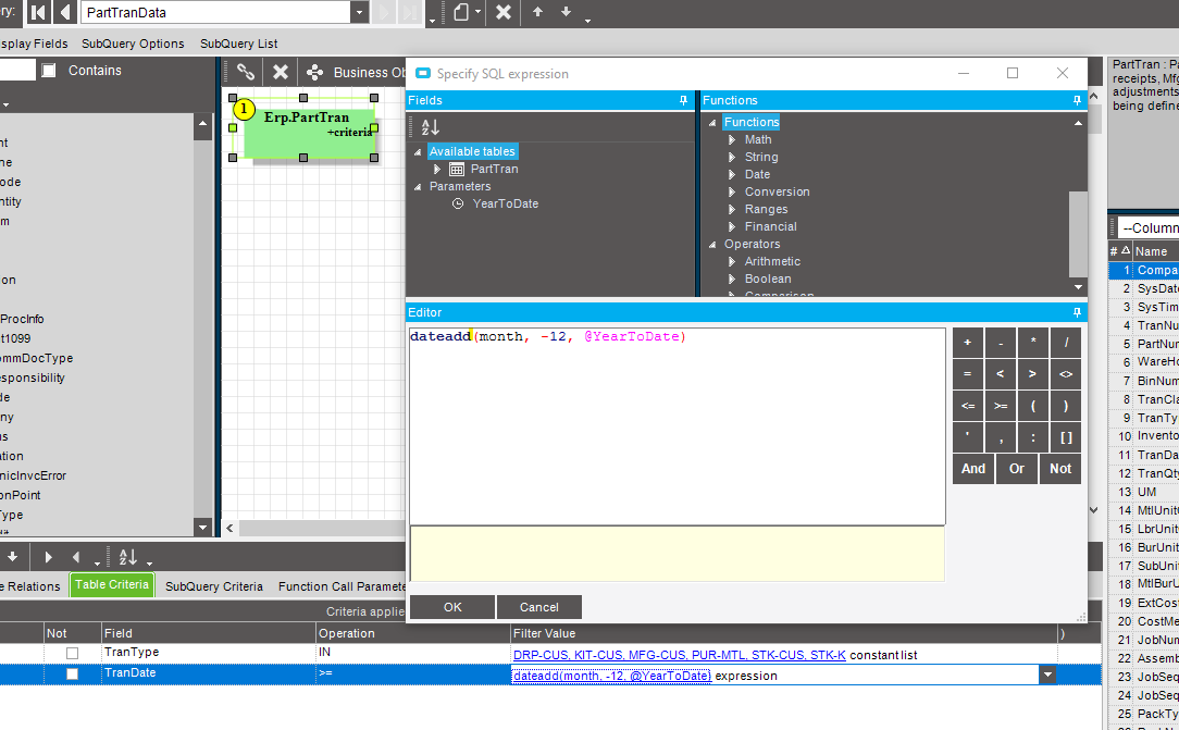

That is odd. In my post with the query expression it uses month in the dateadd() function
