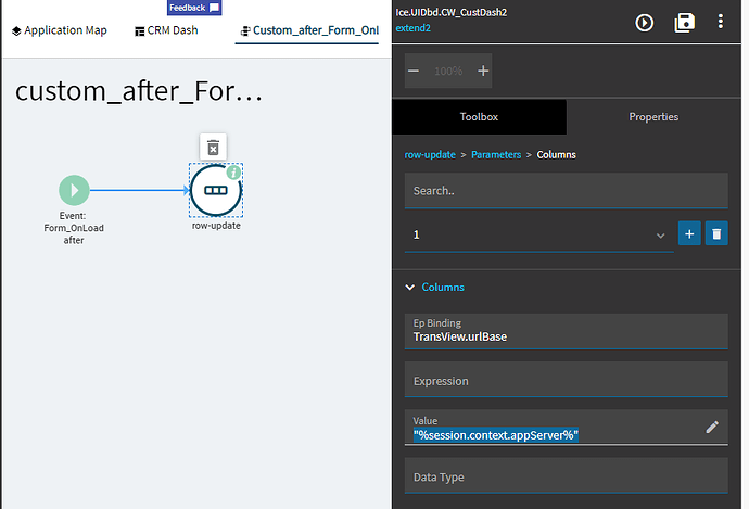

My customisation is now storing this in transView.urlBase in my “after form onload” event:
