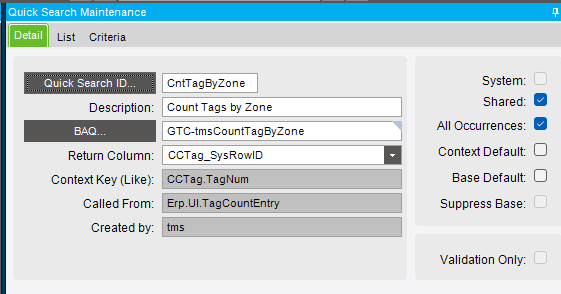

Not exactly what you’re asking for, but for situations where multiple Key columns are needed to pull up a record, I’ve found that returning the SysRowID from the Quick Search works how you expect it to. I’ve done that with a Quick Search for Count Tags.
I tried that and it does not show up in Quick Search for me to select. If I try to set it as the default named search, I get an object reference not set to an instance of an object error. I tried to recreate it and get same results. My Quick Search looks identical to yours. Could it be an issue with the BAQ? Maybe I need to only bring in CCTag table and not include any columns from other tables? That’s worth a shot I guess.
